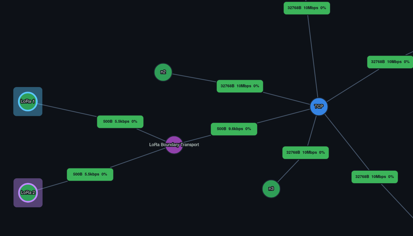

I tried the announce simulator and I think it might actually be incorrect, at least i dont remember it matching IRL behavior.

Boundary mode. In boundary mode announces are sent out to the LoRa network, but throttled and not immediate. Announces from the global network will trickle down through the 2% announce cap.
Nodes that are connected via the LoRa boundary transport can also make path requests to discover destinations on the TCP network
From the manual:
The purpose of the boundary mode is to specify interfaces that establish connectivity with network segments that are significantly different than the one this node exists on. As an example, if a Reticulum instance is part of a LoRa-based network, but also has a high-speed connection to a public Transport Node available on the Internet, the interface connecting over the Internet should be set to boundary mode.
Like this:
