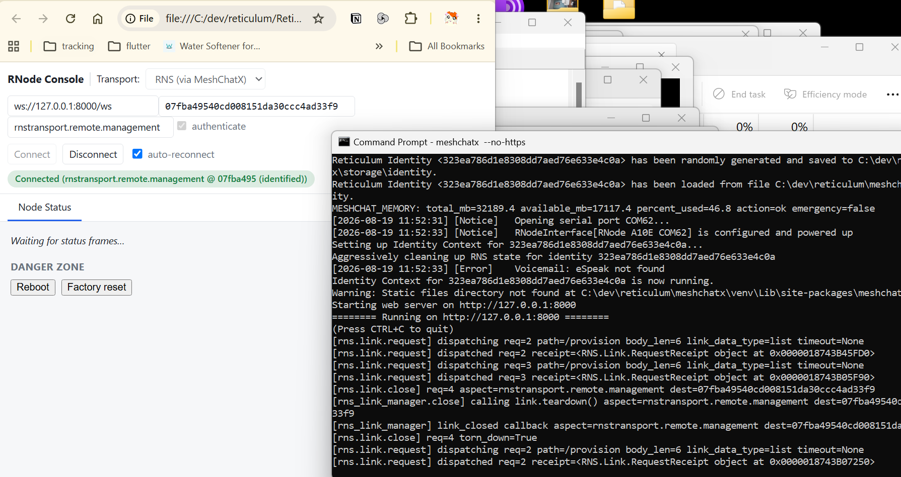

I can't get remote management to work. I installed 1.86.4 on a Heltec V3. I'm using the console.html from that release, along w/ meshchatx from your api_extensions branch. When I connect, I can see a burst of radio activity from the target node that's also received on the node that's tethered to meshchatx. but it just looks like the attached screenshot
no matter how long i wait, console.html doesn't receive any data

Thank you! For some stupid reason, I never thought to try index.html. It connect successfully to rnsapid, but I'm still getting timeouts from rnsapid:
2026-08-21 12:11:44,874 INFO rnsapi.server: listening on https://127.0.0.1:8000 2026-08-21 12:11:44,874 INFO rnsapi.server: listening on http://127.0.0.1:8001 2026-08-21 12:12:03,393 INFO rnsapi.server: ws connected: conn=3b48918d7f13 remote=127.0.0.1 (1 total open) 2026-08-21 12:12:03,401 INFO rnsapi.server: ws attached: conn=3b48918d7f13 session=31a353a32c300d38 anonymous=True 2026-08-21 12:12:03,412 INFO rnsapi.handlers.links: session 31a353a32c300d38 link.open received (dest=07fba49540cd008151 da30ccc4ad33f9 aspect=rnstransport.remote.management auto_identify=True) 2026-08-21 12:12:03,625 INFO rnsapi.rns.links: session 31a353a32c300d38 opening link to 07fba49540cd008151da30ccc4ad33f9 (aspect=rnstransport.remote.management) 2026-08-21 12:12:04,961 INFO rnsapi.rns.links: session 31a353a32c300d38 link 07fba49540cd008151da30ccc4ad33f9 ACTIVE (mt u=500 mdu=431) 2026-08-21 12:12:05,008 INFO rnsapi.rns.links: session 31a353a32c300d38 link 07fba49540cd008151da30ccc4ad33f9 identifyin g with default (71c2af366482e4c4be46cf09cafa61bd) identity 2026-08-21 12:12:05,016 INFO rnsapi.rns.links: session 31a353a32c300d38 link 07fba49540cd008151da30ccc4ad33f9 request /p rovision sending (data_type=list, timeout=30, link_status=ACTIVE) 2026-08-21 12:12:35,023 INFO rnsapi.rns.links: session 31a353a32c300d38 link 07fba49540cd008151da30ccc4ad33f9 request /p rovision sending (data_type=list, timeout=30, link_status=ACTIVE) 2026-08-21 12:12:40,034 INFO rnsapi.rns.links: session 31a353a32c300d38 link 07fba49540cd008151da30ccc4ad33f9 request /p rovision watchdog timeout — RNS did not fire failed_callback (known packet-request bug)

I can see remote node is sending data out, and the local node is receiving data, but rnsapid doesn't know what to do with it, apparently
