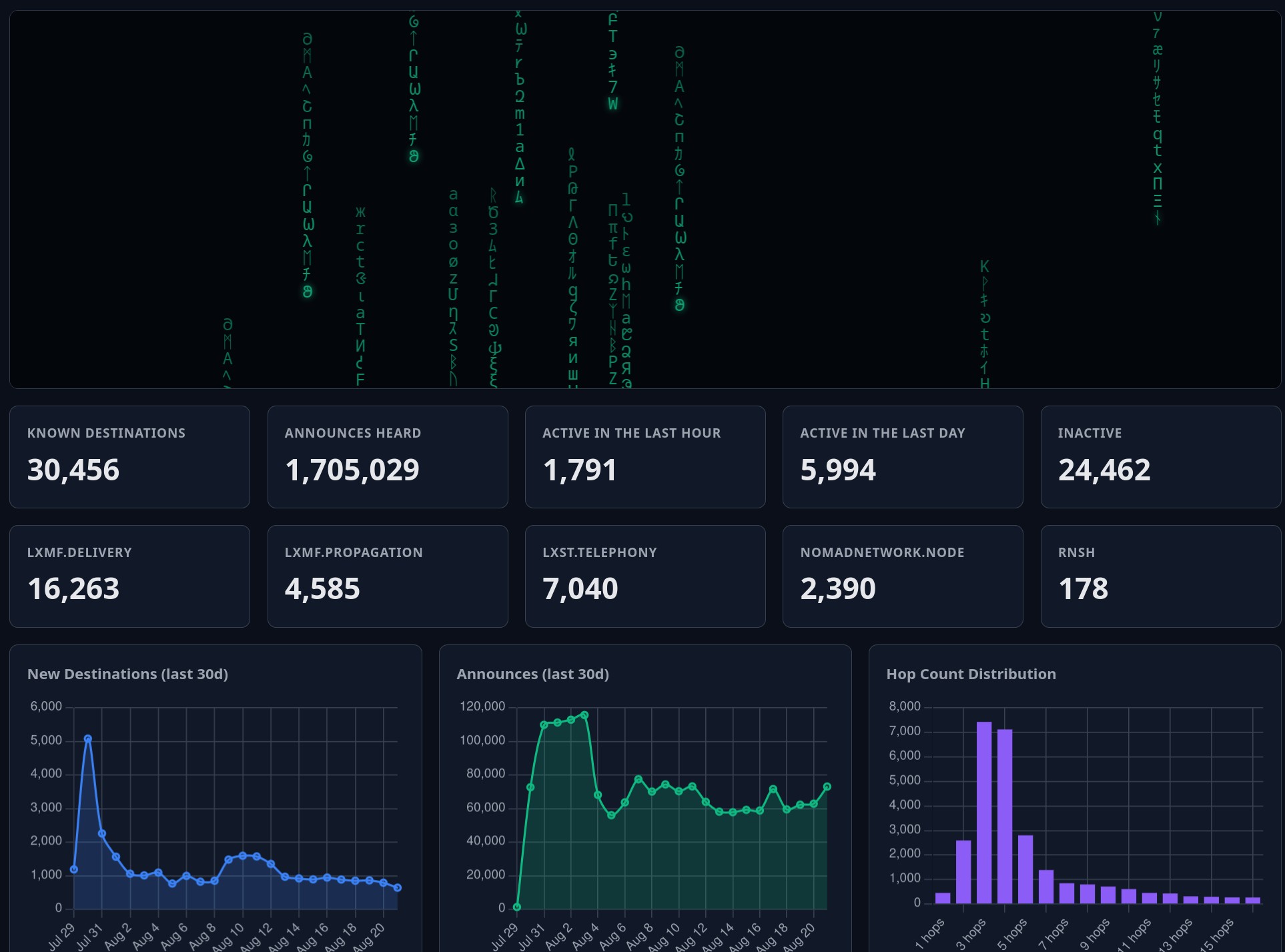

And by random/bogus, I mean that the requested hashes did not correlate to anything heard announced on the network within the last 21 days or so. From a list of 1.7M announces heard, only ~200 of those path requests matched known destinations at all.
Also, just to be clear, there's nothing indicating that the node at that IP is itself necessarily doing anything malicious. It could simply be another client connecting to that node, and dumping massive amounts of path requests, and the node having no ingress/egress control activated (on an old version, or just misconfigured), so everything is just passed along. Either way, a good example of why disabling burst control is a bad idea.
A stats collector? Is that available anywhere?
