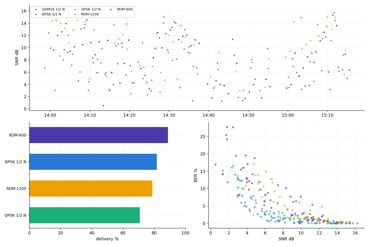

While the automatic gear ladder is still a work in progress, the modes start with the non-coherent MFSK family. MFSK-32 (35 byte payload at 63 bits per second) and MFSK-32R (55 byte payload and 99 bits per second) are decodable down to -8 dB and -7 dB respectively. There is also a work in progress MFSK-64 mode. These modes are intended for extremely poor propagation conditions
Moving up the ladder there are the ROBUST modes. These are designed specifically for higher throughput on the HF bands. ROBUST-1200 can survive 1 second fades and is decodable down to +3 dB providing 1150 bits per second of throughput. RDM-800 (781 bps) and RDM-600 ( 585 bps) can both survive 2 seconds of deep fading and are decodable down to +3 dB and +2 dB respectively.
Moving up from there, for more stable channels such as HF links over NVIS, you can use the OFDM modes from BPSK 1/2 normal to QAM16, which provides up to 3200 bits per second and a 1024 byte payload.
When CSMA (collision avoidance) is enabled, there is some slight overhead due to the channel contention window, but this is highly configurable and optional depending on your needs or applications you use modem73 wit,h.
The results have been validated both on-air and in a ITU-R F.1487 Watterson model
Attached below is some data during a test on the 20 meter HF band @ 10 watts of power over a 1780 km link:
