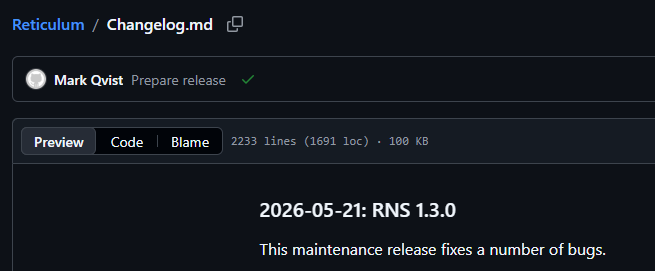

We still have github for now. If that changes I assume we'd have to pull the repo and read the changelog that way
https://github.com/markqvist/Reticulum/blob/master/Changelog.md

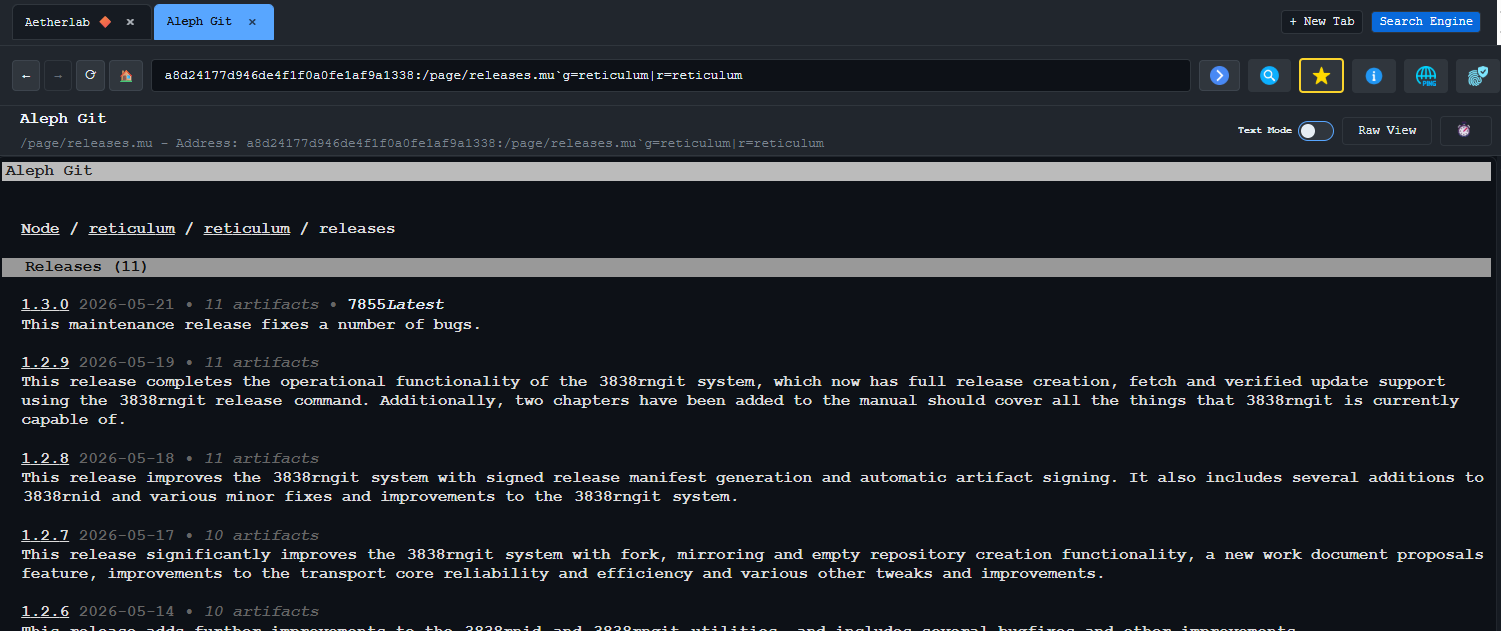

aetherlab 509723a0ccb60610...
GitHub is left behind already. Last version there is 1.2.5, latest release is 1.3.0, can be found on Aleph Nomadnet page. a8d24177d946de4f1f0a0fe1af9a1338:/page/releases.mu`g=reticulum|r=reticulum
Ahyrax 274fd8028990a723...
Not exactly. Github no longer posts releases, but the files themselves as well as all the code are still updated. Including Changelog.md, which I linked and which still has all the updates listed.

joakim b918e659eeedac9a...
edited
I'd say it's the other way around. Aleph Git is where it's at, the GitHub repo is nice to have for people who for some reason haven't gotten themselves onto NomadNet yet :)

Also, while Changelog.md does update on github if/when I do a push to there, I didn't do that at all between 1.2.5 and 1.3.0 I think, so don't expect that to be a live source in any capapcity. If you want live release information, the rngit release list or rngit release view commands are the way to go.

The GitHub mirror has the Changelog.md file https://github.com/markqvist/Reticulum/blob/master/Changelog.md but that mirror is infrequently updated
