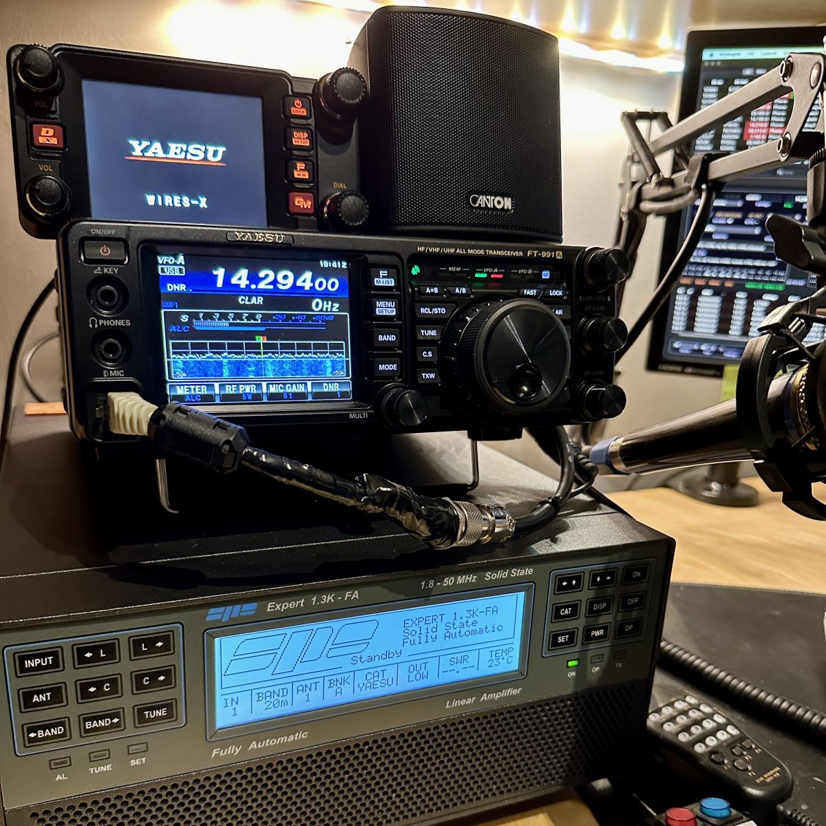

@aetherlab, no I don't have an HF rig. Unfortunately I know next to nothing about radio stuff, but I have that on the list for my next life. Maybe I will take a class in Walhalla ;)
Oh sorry, I meant Mark's picture in Nomad! 73 de LZ1SWE
It's a Yaesu FT991a by the looks of it, which is one of my radios :)

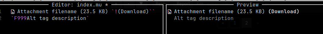

Also it would be really nice if instead of just showing:
We could have something like:
Edit:
Nvm, I just realized that the file size isn't known until we download the remote image. Any way that might be possible without requests? Would it make sense to cache that info in the page itself? Or have it as something that can be passed to the tag?
