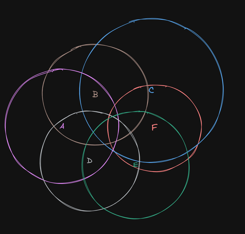

I think the very important question here is why is C -> B unidirectional? Is it just at the fade edge? then sometimes it might still get lossy bidirectional traffic. Is node B intentionally a directional link in C's direction? Is node B just doing Rx-side techniques for better sensitivity, creating that imbalance (kinda implies C is near the fade edge too). One really nice thing about Reticulum is adding a node is cheap (in terms of compute, and overall $ cost all things considered). Plenty of hops are possible seamlessly.
It sounds a bit heavy-handed but ironically the best approach may simply be "add another node or two". Or if you're coordinating (which is what it sounds like from your original post; let's ignore malicious actors for the time being), get B and C on a true point to point link or something.
Not to say some tweaks or application-level choices couldn't help smooth those over! But I think the fundamental problem still might lie somewhere else
edited
Even if you add a node in between C and B, let's say node Z, wouldn't node B hear an announcement from C first instead of Z anyways, thus then just prioritizing and trying to resolve paths through that unidirectional link ignoring Z and trying to go straight from B to C. If you get to organise the nodes yourself you could maybe control this, but if not in a randomly distributed sea of more and more transport lora nodes in one area, the chance that any one of the receivers is just in the perfect range for the the transmission to be unidirectional increases , and because those links would be the most efficient route for traffic to pass if they were good connections, a lot of traffic will try to go through these links and fail one way or another.
edited
I hear ya, and I promise I'm trying to steelman this side too! Where it gets weirder though is when we lift out of the diagram which is basically modeled as a bunch of point-to-point links, right? In reality we're probably talking the typical dipole donut broadcast from each node.
It's already WAY harder to even create this configuration once you deal with that (and ignoring other 3d geometry or interference; even just assuming "a wide open plain" where each node lives, this is the kind of arrangement it would have to look like to fit that diagram
Notice how even here, C has to have a notably broader reach than the others. and E is nearly hearing it too. IT's just really really hard to create that arrangement in actual all-lora-only-broadcast scenarios.
If C has similar reach as the rest, then it quickly would end up in a spot where it would be bidirectional
Since this is LoRa and on boards we're probably talking about, there isn't really much "rx-sensitivity tricks" going on there, the main variable will just be antenna placement, interfernce, and power (like a heltec v4 having 28 vs 22 for example)
And it's pretty load-bearing that B itself is just reliably, losslessly just always faster to get there in the first place, which seems unlikely for all sorts of reasons from CSMA/CA behavior to moving interference to announce queueing and so on.
THis is just an extreme edge type of case, and I think the final rub is this:
Even if you accounted for all of this, and made explicit adjustments for this exact kind of scenario, that all becomes moot when node A can still end up with a bad link via that path for whatever other reason haha. the joy of distributed systems, right?!
"try, observe, adjust" from A's PoV really is the only way to appropriately handle lossy links, for whatever reason it's lossy. And after first failure you have a working system.
To nilu's point, yes after C announces this could reset. But the announce rate by default is 6 hours.
The one, simplest change I could think of (and note I have not traced any other ramifications of this yet), is that paths that are currently marked UNRESPONSIVE don't get sent back as a response to a path request (which would just allow D to cleanly win on the first re-attempt instead of the jitter dance)

Also, other transport nodes (in RNS, not LXMF) only react during the Link case. Transport nodes 1 hop away to the initiator or recipient mark the path unresponsive when the Link fails.
This same thing keeps coming up now, and it seems like the thread here agrees: a node really shouldn't reply to a path request if that path is currently marked unresponsive. I think this is very high priority:
  • It's a very small change in terms of code
  • It's semantically accurate and sensible. "Someone else doesn't know of a clean path, and is asking its neighbors if they happen to know" is the point of the path request. An unresponsive path is not helpful, and as we can see here, sometimes actively unhelpful.
  • It integrates cleanly from day 1. Nothing about this would break other nodes that don't have this change yet
  • It's extremely high value: it takes us from hoping the jitter race wins, to reliably getting the better path every time.
For the Link case, this would basically solve the entire problem on its own, since transport nodes in RNS already play nicely by marking their paths unresponsive when Links fail.
In fact, that's not even really my solution proposal, because that seems like a shoe-in at this point. Happy to hear thoughts from everyone else if they see clear issues with, or objections to, doing this!
I'm going to break the proposal into a separate message beacuse it includes a wire change, and that warrants an isolated review.
This proposal would extend the previous benefits to SINGLE DATA packets (and by extension, LXMF's OPPORTUNISTIC message type), not just Links.
This following fix is also quite simple & integrates cleanly, but due to it including a wire modification, is also a call for scrutiny from you, the reader.
A SINGLE DATA packet should have a way to say "the initiator is expecting a proof". It doesn't change recipient behavior (and it shouldn't; this is the trap to be careful to avoid). Recipients still decide to prove or not.
Note that LXMF already proves every packet itself, so most nodes out there already choose to prove. That's one reason this integrates cleanly
Thankfully, the context flag is still fair game for a SINGLE DATA packet. Currently it just gets ignored and then ultimately zeroed out by every transport node when the packet is forwarded. That happens because each transport node constructs a new flags byte, and only carries parts of the old one across. Context isn't actively preserved, so by omission it gets effectively set back to 0.
So, the first proposed change is for the initiator to set the context flag on a SINGLE DATA packet when expecting a proof to come back.
The next change is transport nodes marking that expects-proof flag in their reverse tables, and forwarding the context flag instead of zoeroing it by omission.
Then, the node should also mark the path unresponsive if the expected-proof (context flag) was set but the proof timed out. Setting this up can just use the same proof_timeout configurations we have for Links, since it's already proven and useful there.
Assuming the previous shoe-in change is also live (unresponsive paths don't get sent in response to path requests), this proposal improves that change by also applying it to single-data-with-proof-expectation scenarios.
Also a nice relief: the context flag doesn't change the proof hash. Proofs would still match with zero special handling, even for current nodes out there. The wire change is actually poised for a clean integration with no extra work; not anywhere as scary as something that requires careful migration.
And one final change is needed too: RNS finally uses its mark_path_responsive (which is currently declares but is not called anywhere), to heal its tables when it does get a proof back, for both Links & singles.
Thoughts, objections, additions, concerns?
