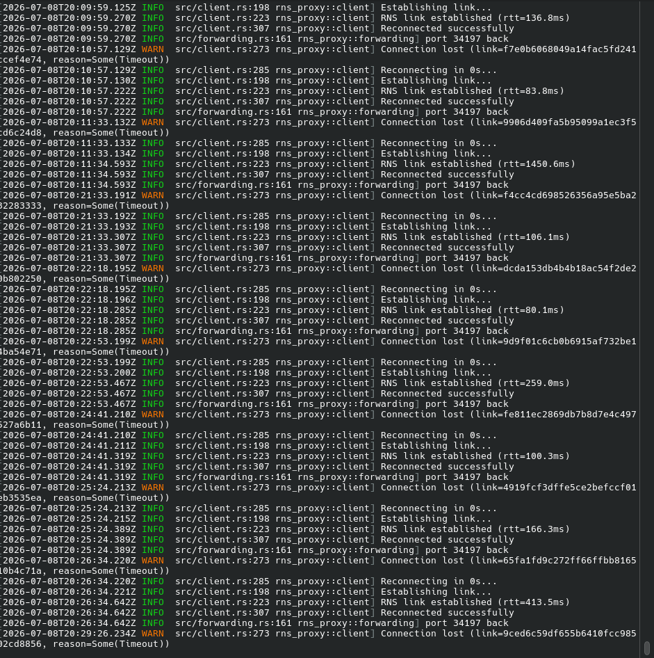

Currently forking rns-proxy to add udp support and other utilities to tunnel regular internet traffic through reticulum (coming soon in showcase post) but I keep having the issue where my links disconnect often enough that it's causing real issues and would make this way less useful for real usecases, happens roughly every 2-3 minutes after forming the link but can be anything between connecting for about 5 seconds and 20 minutes.
To ask the title question, Are links normally this unstable? I'm directly connected to the reticulum instance I'm connecting to, which also happens to be a public backbone running on a spare pc on the same network, and so latency and network throughput shouldn't constraint. I was originally gonna blame and possibly fix the rns-net implementation but I remember that even using rnsh on my personal devices would have similar issues where it'd disconnect pretty often even with a direct backbone connection.
Are links just like this? I could always switch to using normal packets from the link destination to avoid this and reconstruct the stream myself, might make more sense specifically for udp as it's not meant to reliable like tcp but fragmentation (Internet MTU >> Reticulum MTU) and as well as I think being more inefficient than a link destination (according to the docs anyways) makes me second guess that possibility.

Okay I discovered that this had more to do with autoconnect_discovered_interfaces and reticulum's pathing (maybe)
I originally had autoconnect_discovered_interfaces set to 80 from earlier testing and messing about and I assumed reticulum would recognise the direct LAN backbone connection between my computer and my server 5 meters away, but it turns out RNS would instead send the link through some foreign flacky connection with little bandwidth instead my local LAN connection, turning off that setting and only having that LAN connection solved all issues instantly. Even when I explicitly would connect to a server half way across the world, as long as it was a server with good bandwidth, there was no issues.
I can't tell if this rns-net being ass or if the reticulum python implementation that I had running on both machines was causing the issue, but It's good to know that more interfaces isn't necessarily better
