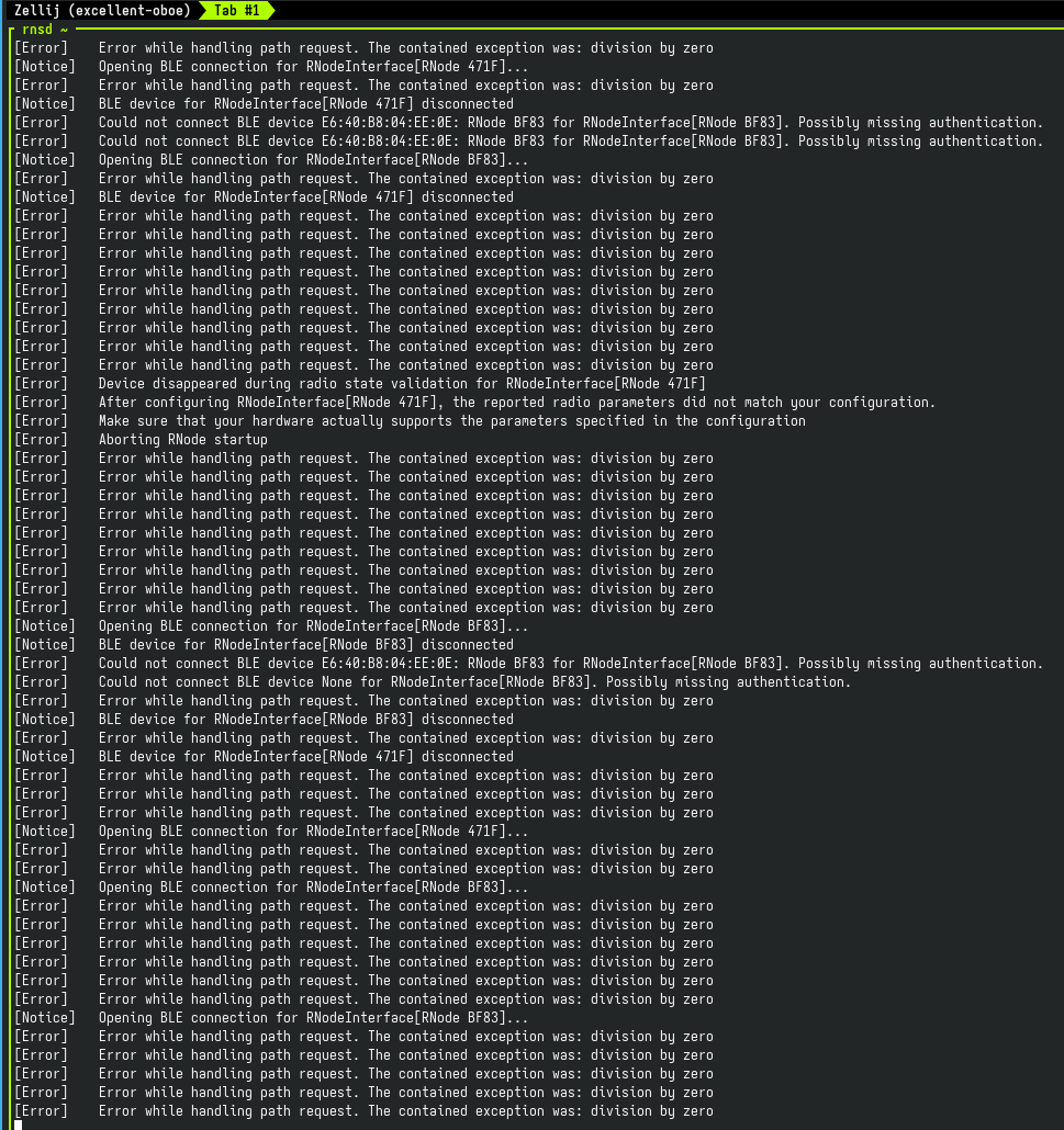

Hello all,
When running rnsd 1.4.0 locally, I frequently see the following error in the logs:
[Error] Error while handling path request. The contained exception was: division by zero
And today, I would like to know where it comes from... I did a small investigation.

p1ld7a b2e101f8b8d8c776...
I did it, here's the result:
[Error]    An unhandled <class 'ZeroDivisionError'> exception occurred: division by zero

RNodes initialize self.bitrate = 0 and only update after getting telemetry from the device. So offline/reconecting/partial init BLE Rnodes can remain at zero.
You've got a few on there so probably various ones you've tried over time, or conditionally available ones, yeah? That's probably it

I added a few more debugging information, especially in request_path():
[Error]    Recursive path request on Shared Instance[rns/x1c]: bitrate=1000000000, announce_cap=2
[Error]    Recursive path request on BackboneInterface[rns.not-a-number.io/192.168.2.116:4242]: bitrate=100000000, announce_cap=0.02
[Error]    Recursive path request on AutoInterface[auto]: bitrate=10000000, announce_cap=0.02
[Error]    Recursive path request on BackboneInterface[Dark Doodad 23/207.174.40.24:4242]: bitrate=5000000.0, announce_cap=0.02
[Error]    Recursive path request on BackboneInterface[Mari El RNS/rns.lngserv.ru:4242]: bitrate=5000000.0, announce_cap=0.02
[Error]    Recursive path request on BackboneInterface[Northern Ireland MySQL proxy/northernirelandreticulum.uk:3306]: bitrate=5000000.0, announce_cap=0.02
[Error]    Recursive path request on BackboneInterface[DjVolSky TCP/rns.djvolsky.ydns.eu:4242]: bitrate=5000000.0, announce_cap=0.02
[Error]    Recursive path request on BackboneInterface[rns.quacksradio.com/rns.quacksradio.com:4242]: bitrate=5000000.0, announce_cap=0.02
[Error]    Recursive path request on BackboneInterface[Arg0net RNS-VPS Italy/82.223.44.241:4242]: bitrate=5000000.0, announce_cap=0.02
[Error]    Recursive path request on BackboneInterface[CORE - Central Ohio Radio Enthusiasts/rns.core.radio:4242]: bitrate=5000000.0, announce_cap=0.02
[Error]    Recursive path request on RNodeInterface[RNode 268C]: bitrate=1074.21875, announce_cap=0.02
[Error]    Recursive path request on RNodeInterface[RNode 9891]: bitrate=1074.21875, announce_cap=0.02
[Error]    Recursive path request on RNodeInterface[RNode 471F]: bitrate=1074.21875, announce_cap=0.02
[Error]    Recursive path request on RNodeInterface[RNode 869C]: bitrate=0, announce_cap=0.02

    tx_time   = ((len(path_request_data)+RNS.Reticulum.HEADER_MINSIZE)*8) / on_interface.bitrate
ZeroDivisionError: division by zero
[Notice]   Opening BLE connection for RNodeInterface[RNode 869C]...
[Error]    AutoInterface[auto] No multicast echoes received on wlan0. The networking hardware or a firewall may be blocking multicast traffic.
^C^C⏎
We notice:
This is the one causing the issue.
Those RNode are actually all valid, it's just that RNode 869C is out of reach at the moment.
Thinking out loud here but perhaps we could improve the path resolving mechanism by filtering out interfaces where bitrate is equal to 0 ?
Good debugging :)
Should be fixed now in 4760103aa660f3fdd628a8124875dda672a71ac9:

Wow speedy fix!
Huh, on the web the diff addition gets rendered in a different font to the rest of the diff, making the indent appear incorrect.
Thank you Mark, you rock :)
Yeah, I did notice that indent weirdness on the web version, nomadnet works fine. I figured it would make sense anyway ;)
Thanks p1ld7a! If you tried out the fix on your system and it actually works, let me know - would be good with confirmation that it actually fixes it when the RNode is not connectable and startup (and if it goes down subsequently - but should only really occur if it can't be brought up on start).
I confirm the fix works as intended, successfully !
