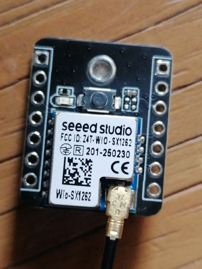

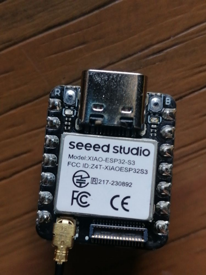

Here's the exact two chips in case it is at all relevant. Looking at other Seeed node's people have gotten they seem to be slightly different but I can't tell if that's a relevant factor

This comes up regularly in channels, and I believe this is because there are two forms of the Wio-SX1262, v1.0 and v1.1 (check the reverse side of the Wio chip, it's printed on the board which version it is). It's likely that you have the v1.0 for XIAO which uses different pins than what is mapped out upstream IIRC, which only considers v1.1.
For v1.0:
CS = 5
RESET = 3
DIO1 = 2
BUSY = 4
RXEN = 6
SCK = 7
MISO = 8
MOSI = 9
If you don't have v1.0, then I'm not sure, sorry!
dude.eth
Okay actually ignore that, I just checked my v1.0 and yours is definitely different, so I don't think it's v1.0.
edited #8
I can't upload the pictures but on mine it doesn't say V1.0 or V1.1 at all (just says the chip name), so I think I have an entirely different version
Though given what you said, it just sounds like I have to find which pins correspond to what and then edit to the corresponding pins in the build configs. I'll also have to try using the esp without the xiao, since if that has incorrect pin then those incorrect signals may be causing the thing entire thing to brick, would let me isolate the problem to specifically that device. Unfortunately I have assignments due so I'll have to look in to that later next week, thanks anyways.
