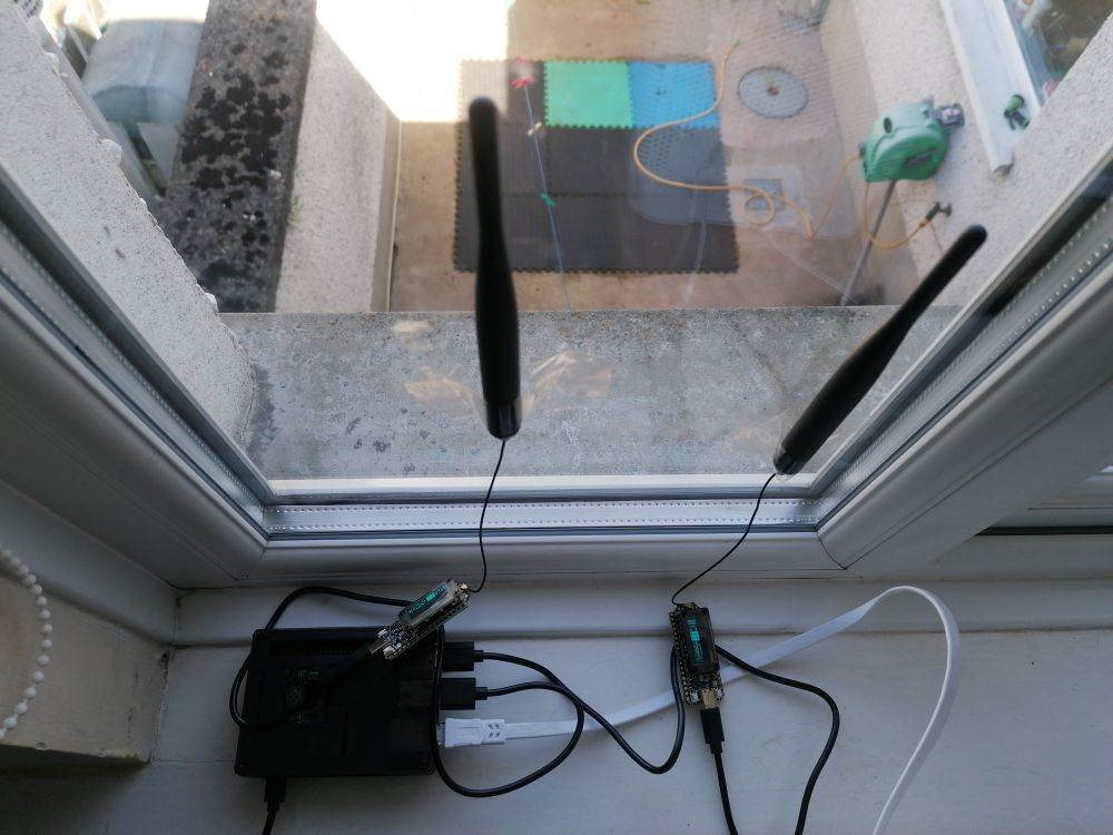

Nifty little set up. Got a medium bitrate medium range and a low bitrate high range rnode connected to one raspberry pi 2b

Nice little windowsill node :) If your deployed nodes are rPis connected to the internet, you could run rnsh so that you can remotely administrate them and change LoRa parameters. I'm thinking along the same lines as you, and that's my plan so far. I think it will take some experimentation to find out what works best.
#16
Oh nice, look good! the simple tape against the window makes me think "why didn't i think of that sooner??" That probably would've saved me buying one case for one of my indoor nodes haha. nice lil trick, thanks for sharing
#20
Just keep in mind, that if the window has low-emission glass (metal laced glass), you not only will greatly attenuate the signal outside, but also detune the antenna resonance and make it an improper load for the LoRa radio, which will result in even worse performance. Clear simple glass is RF transparent and will not detune the antenna. I would not put antennas in touch of anything, if possible.
