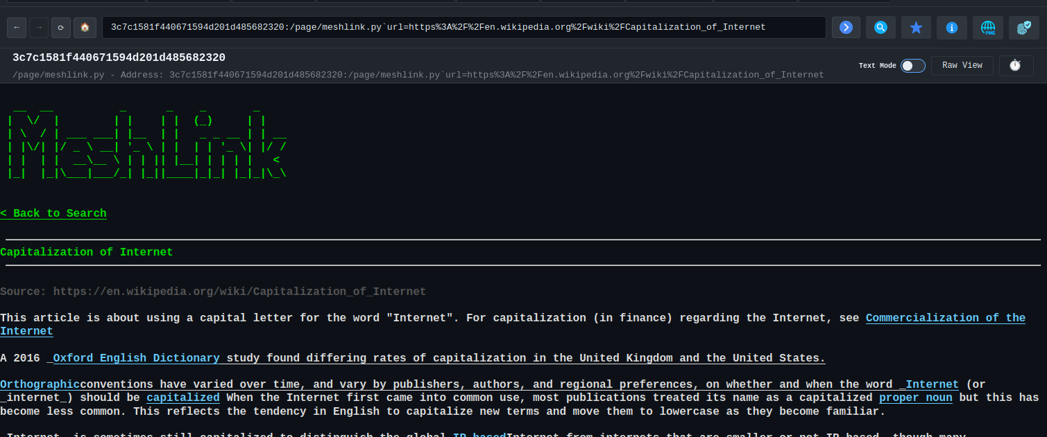

Yea this would probably do the trick. It's also what roogle and meshlink uses too image.png
