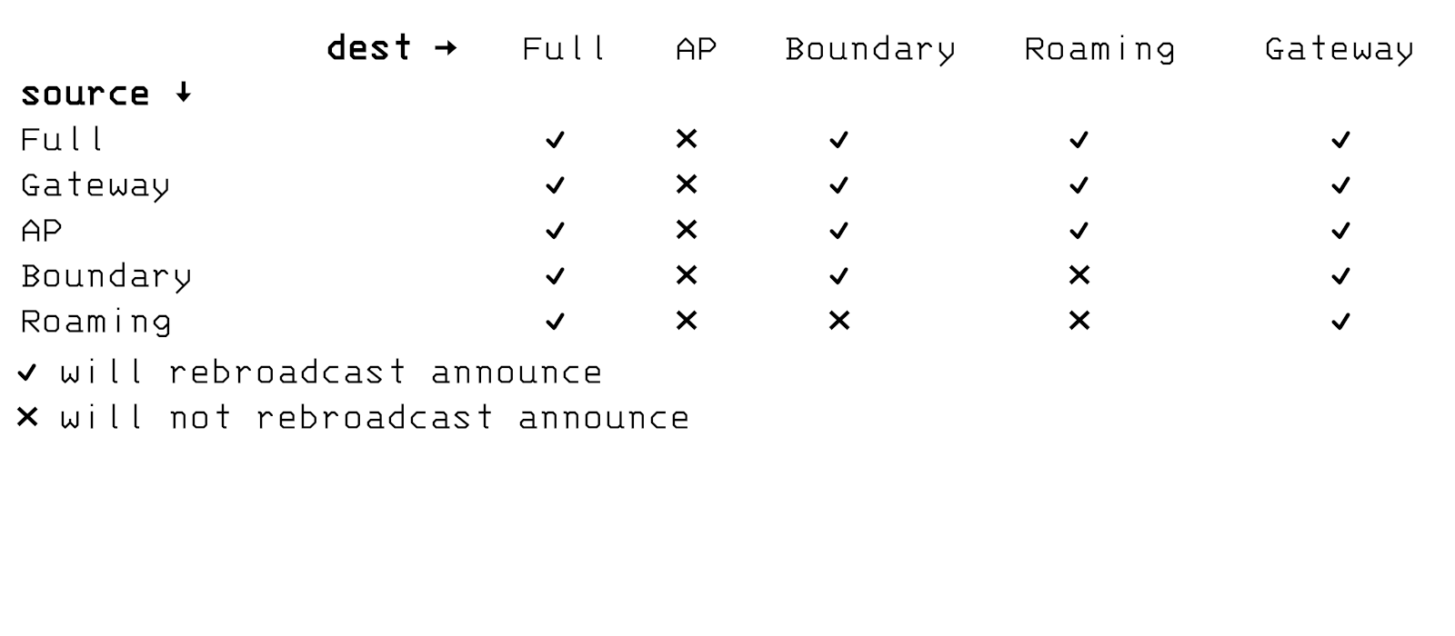

Also your Transport would not be invisible to the network in boundary mode. If you need a bit clearer picture of the announce prop rules, see the image below.
