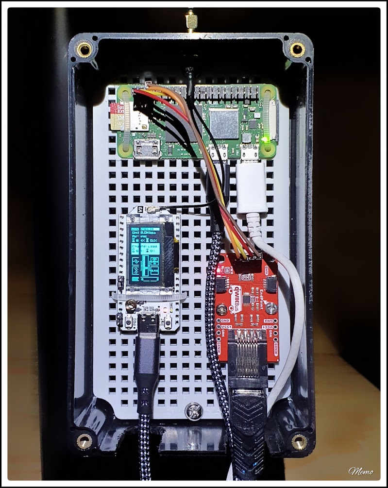

Last year I used a Raspberry Pi Zero 2W for a sensor node. That was really pushing the limits. I rather doubt that a Raspberry Pi Zero W will work.

Did you measure it, or did it just feel sluggish, and in what way? I am. nterested what pushing the limit actually means and if its something I maybe am ok with.
