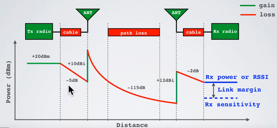

A bit more on the topic with a nice graph from the web:
Here you have the whole RF link depicted, one way. You have a 20dBm or 100mW (20dB over 1mW, remember?) power output capable transmitter. You feed this power to the antenna, trough a coaxial cable, that has around 5dB of loss for your frequency, leading to 15dBm or 32mW reaching the antenna, as you have lost 68mW in the cable. As this is 68% i never stop urging people to use good cables, connectors and common sense, when deciding to use a 100mW node trough 10 meters of coax cable, that has 3.5dB loss per meter at their frequency... Now, the antenna is resonant and has actual gain within the frequency range of interest. No, IT DOES NOT AMPLIFY, it just focuses energy in certain areas, just like a magnifying glass does not AMPLIFY sun's energy, it just places it all onto a tiny area, actually increasing POWER DENSITY. So this antenna is presumably DIRECTIONAL, with 10dB of gain, which would give us an equivalent 10-fold increase in power over the focus area, that will take us from 32mW to 320mW EIRP or Effective Radiated Power. Good! Now we have the air, we have water, particles, losses, reflections, it is a messy chaos for a radio signal, and in the end, when we reach the receiver, we have lost so much signal power, that we are at -115dB below the transmit antenna level, or... -90dBm! This a TINNYYY amount of power with so many zeroes in front of it, I have no intent on trying to write down. Now, our receive antenna is EVEN BETTER, having 15dB of gain, or almost 32 times the power, bringing us up to -78dBm of signal level, still crazy small, but well into the sensitivity range of the receivers we all use. KEEP IN MIND I don't talk about SNR here! Just COMPLETE signal levels, with noise and all, whatever is on the frequency. Again, we lose 2dB, or 1.6 times the power in the freakin cable, until we get to the -80dBm of a signal, we can give to our receiver.
If you take all the losses in the link, air, cable, whatever else, and compare it with what is your receiver's sensitivity and capacity to distinguish signal from noise, you will arrive at you LINK BUDGET, a number which will tell you if this link is even possible, or you need more power, better antennas, less losses, better antenna placement, etc. Or just nothing would help...
