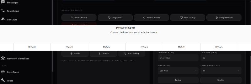

Some of the earlier attempts included running microRNS [https://github.com/attermann/microReticulum_Firmware] with one of my 4630s as this build includes a 3400 config and i am less worried about bricking the cheaper one. It switched between not exiting DFU mode, changing its port during flashing, and failed to start. This was attempted over python over powershell, a windows install of meshchatx, and the same python script but on linux. We could not do it on meshchat on linux due to UI issues when trying to use serial support [see image 1].
