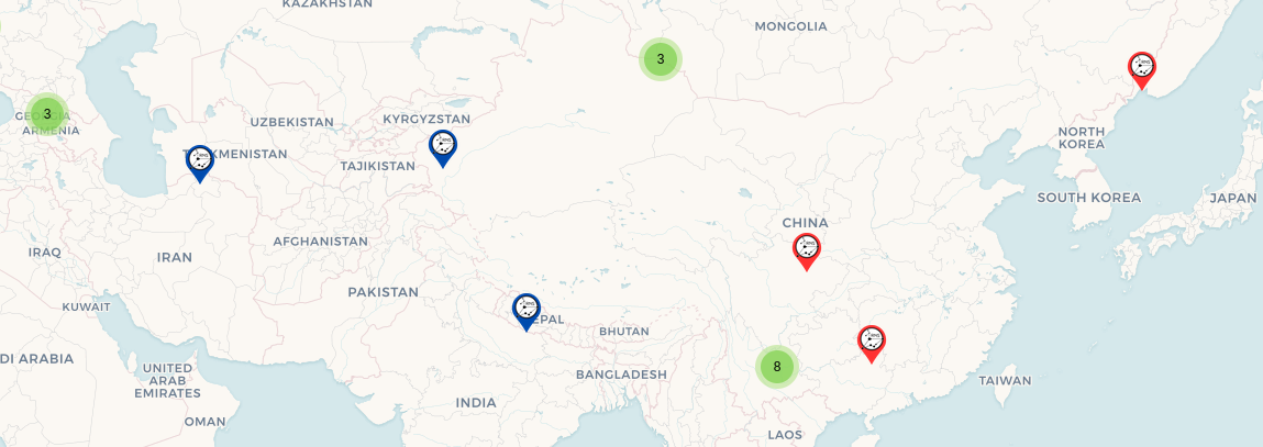

I live in a privileged democratic and free country so do most people here, so we lack good perspective on how it's like to live in more censored regimes
(screenshot of rmap.world showing china to iran with quite a few nodes)
If you are from a country that isn't as friendly, give your thoughts, wants and fears when it comes to reticulum. If you are operating a node there, how is that like?
