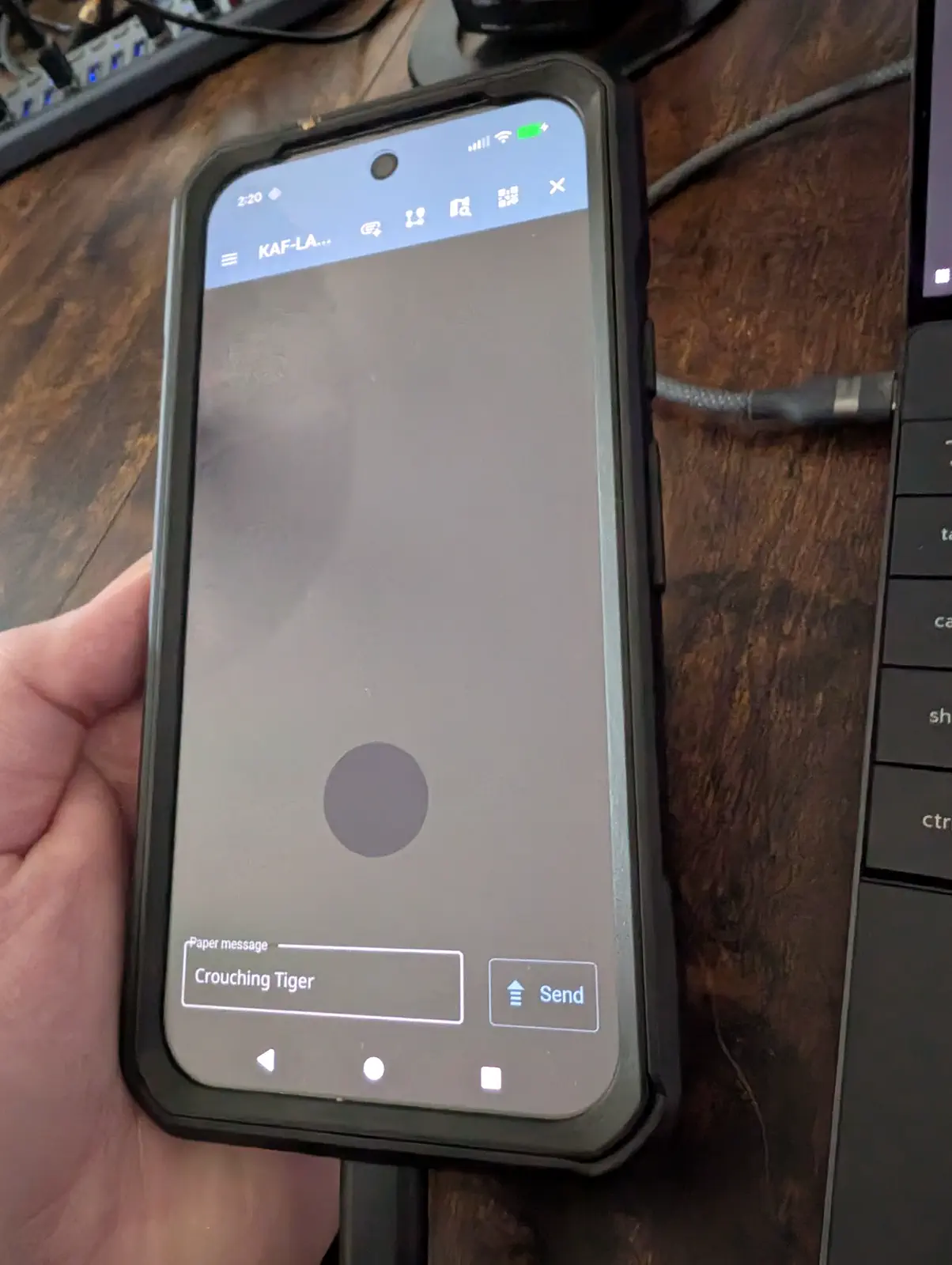

  1. Clean message history to start

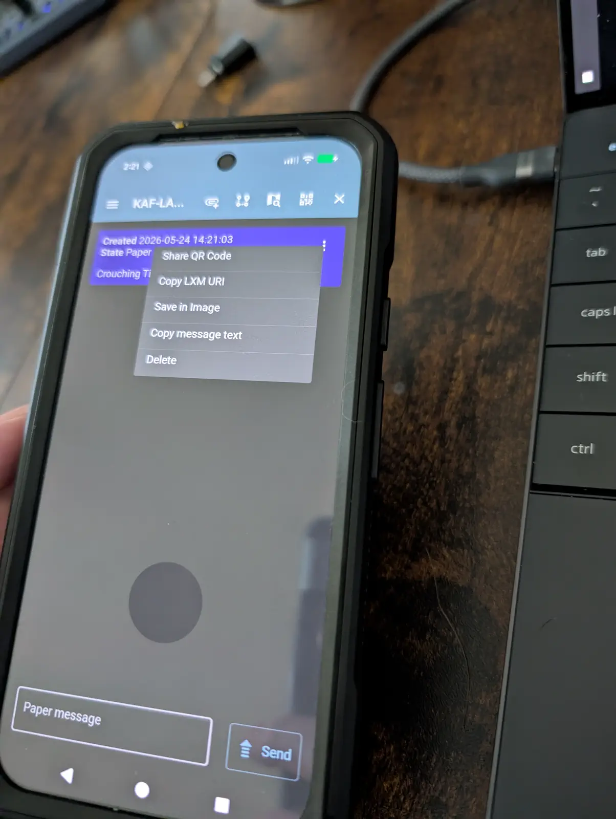

  2. Send a paper message the normal way, new dropdown option, "Save in Image"

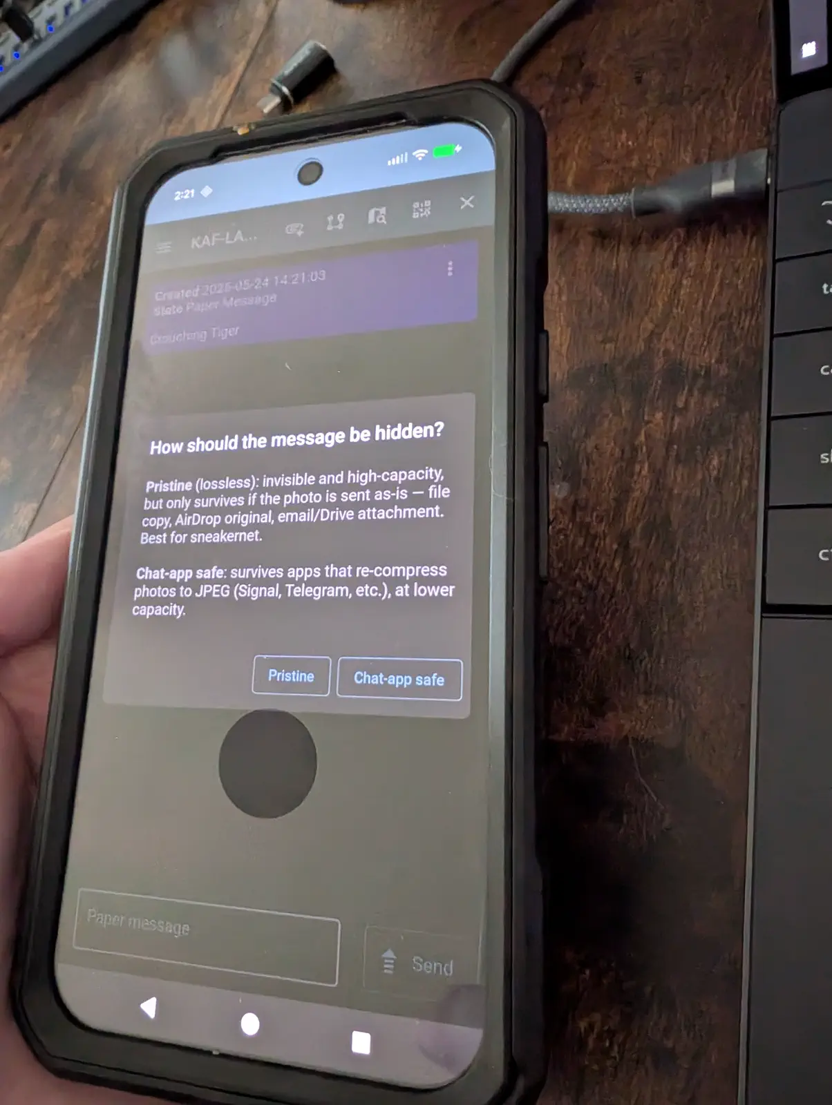

  3. Two modes: one with higher capacity but won't survive compression, and a more robust but lower capacity one.

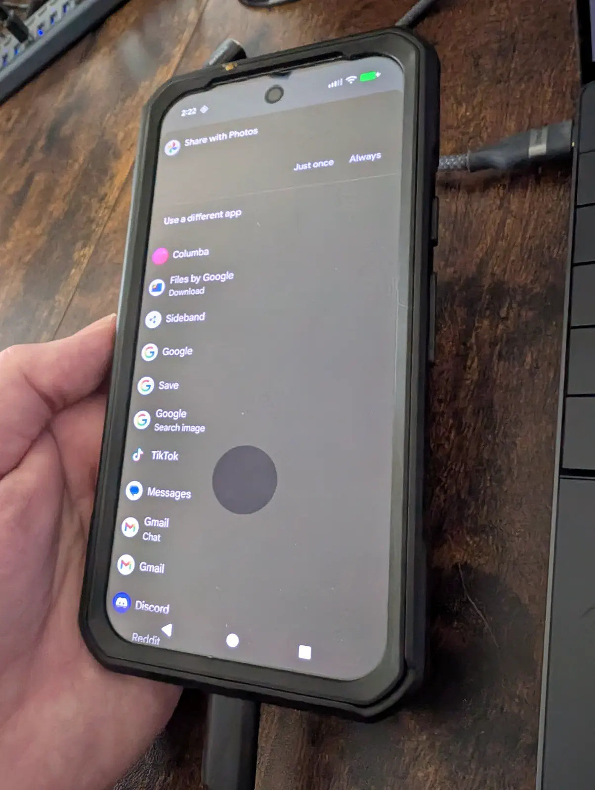

  4. Pops open the share dialog.

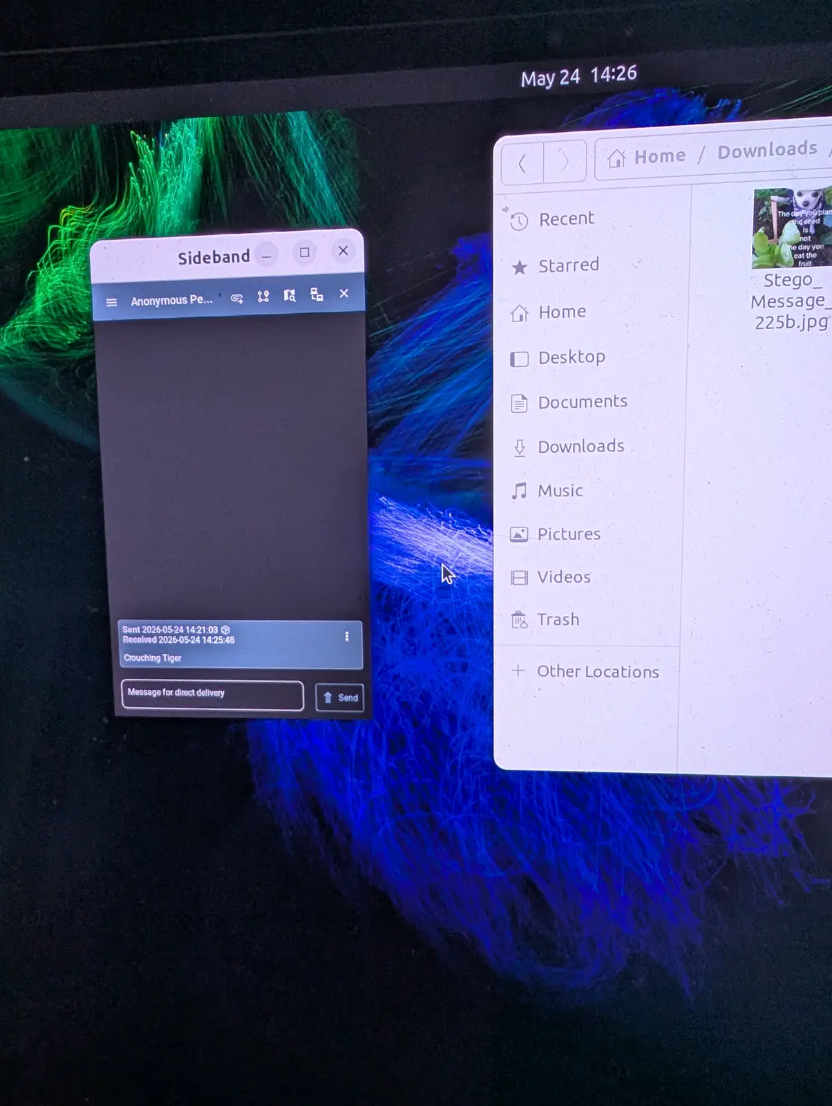

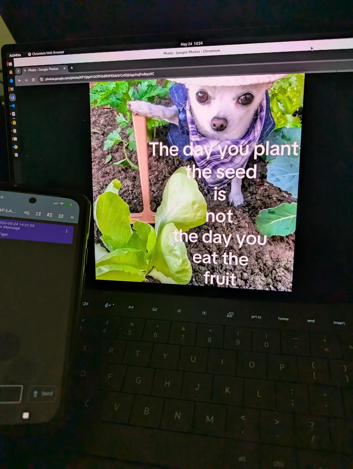

  5. For my test I just sent to google photos for an easy and fast way to get the image down on my laptop, and here you can see the image

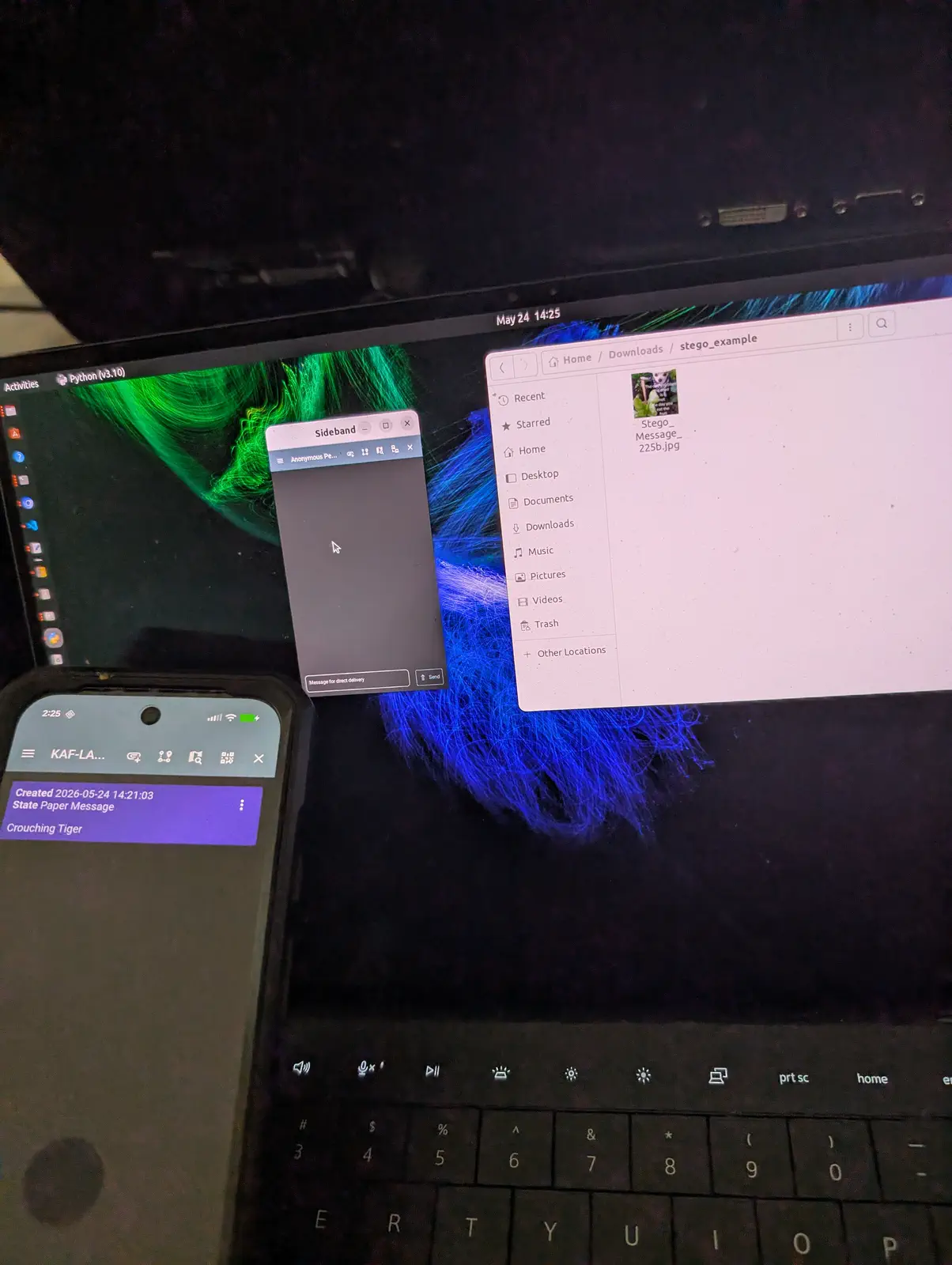

  6. You can see the downloaded file on my laptop, and my laptop's Sideband with no message history yet

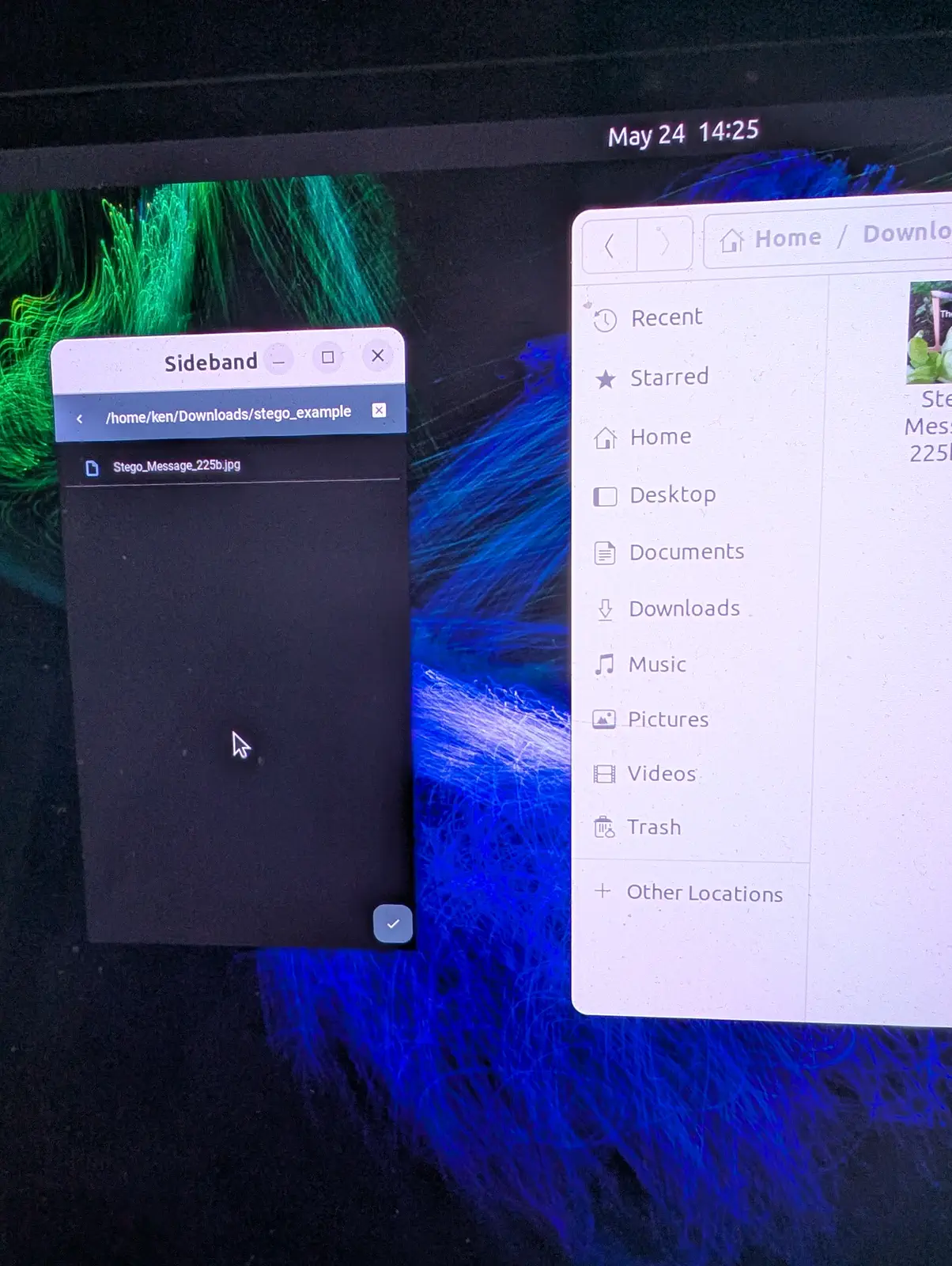

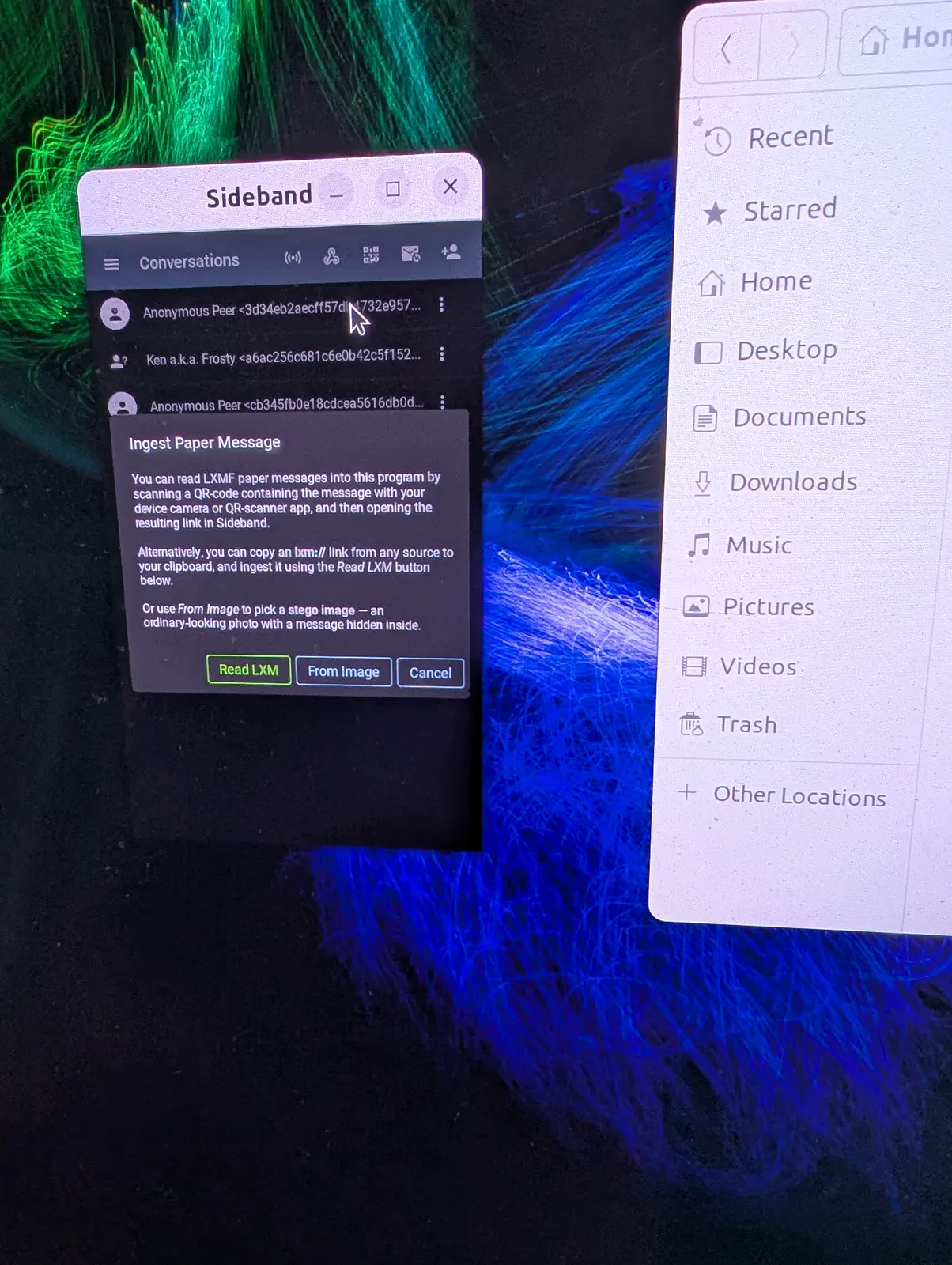

  7. Same flow as other paper messages on the ingest, but now a 'From Image' button option
  8. Pick file

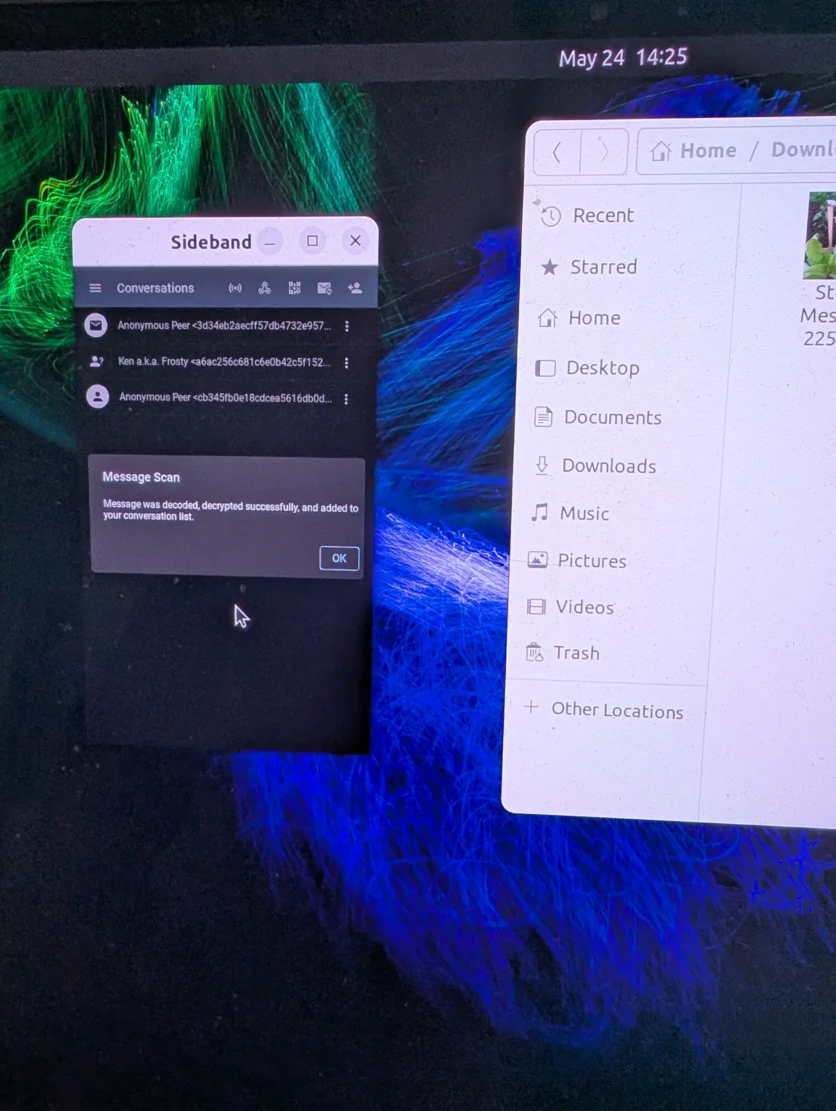

  9. Confirmation!
