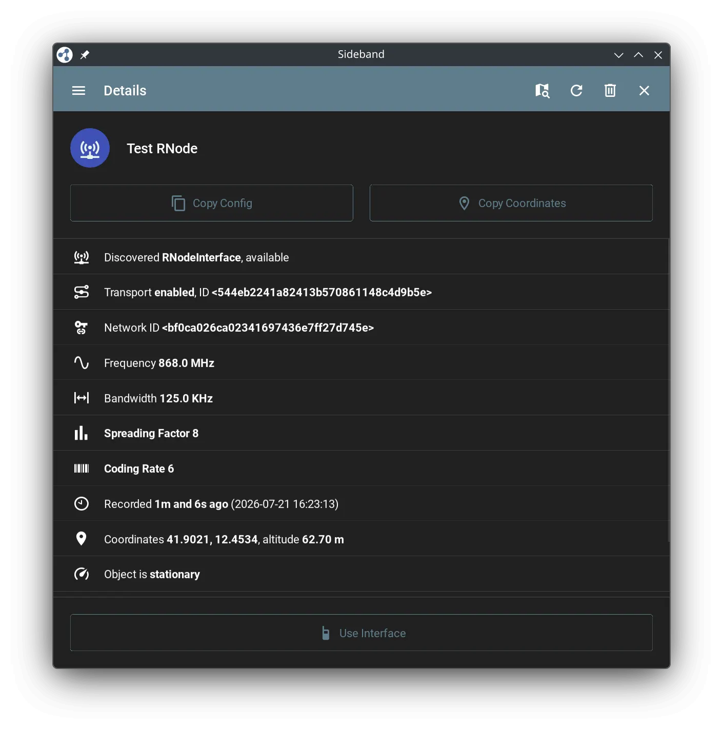

In the latest version of Sideband, it's now possible to view discovered interfaces on the map, and to connect to them from the Object Details screen. On Android, this will directly configure the interface and restart the RNS service. On desktop, you can copy the interface config snippet into your RNS config file.

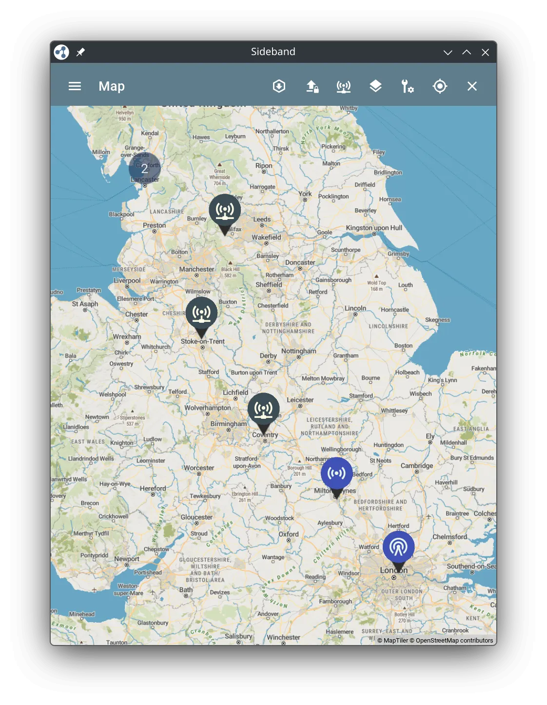

Anyone that is authorized to pull telemetry from the node will then have the interfaces visible and connectable on the map.
In the above screenshot, the grey interface markers come from the interface discovery system, and the blue ones were received from a telemetry peer. This of course also works over telemetry collectors, so you can have any number of nodes that publish their interface configurations to a telemetry collector, and peers who are authorized to pull telemetry from that collector can then view and connect to any of the interfaces.
All in all, this makes it much easier to roam between different radio configurations or use different backbone uplinks, since all the information is always locally stored and available in the on-device telemetry database.
