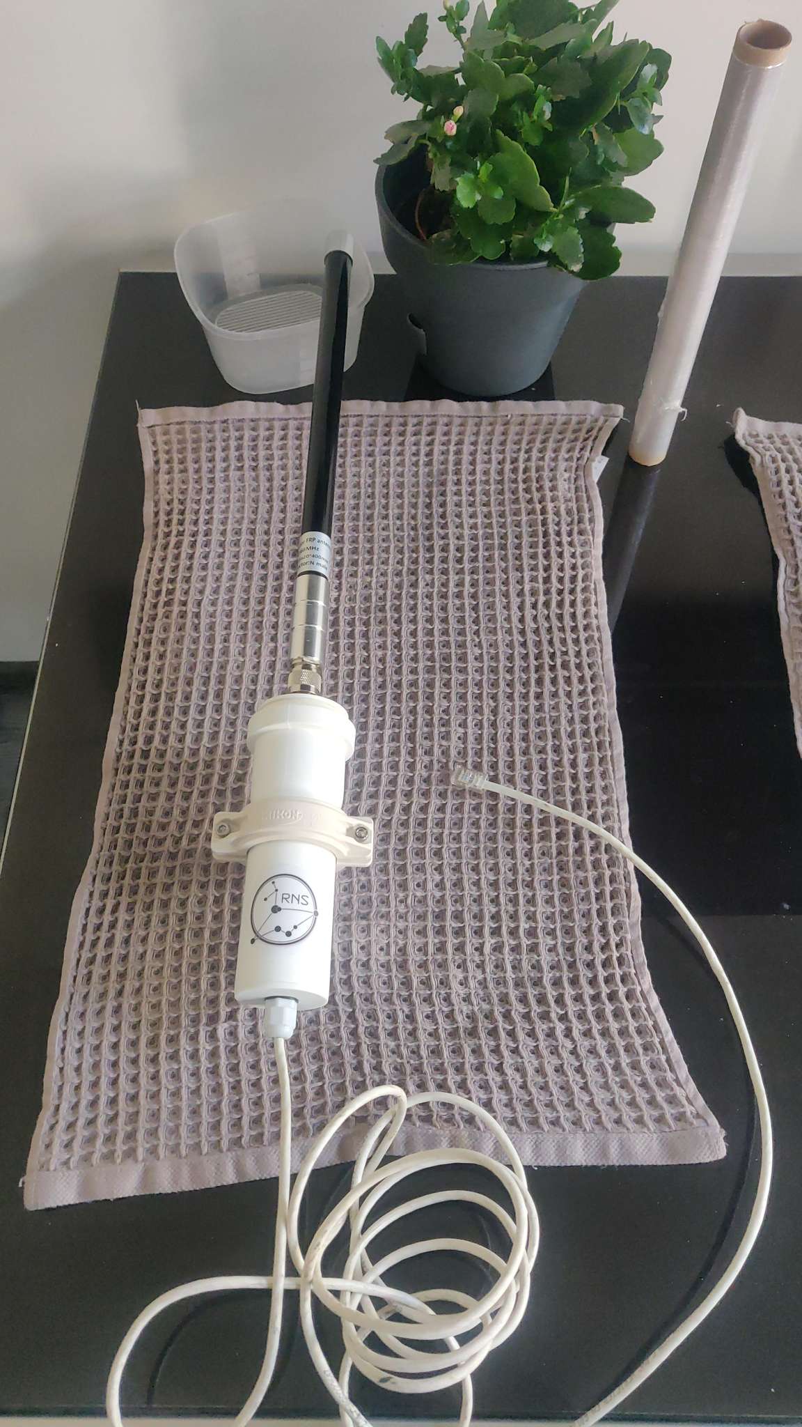

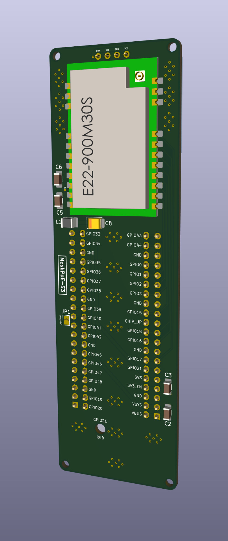

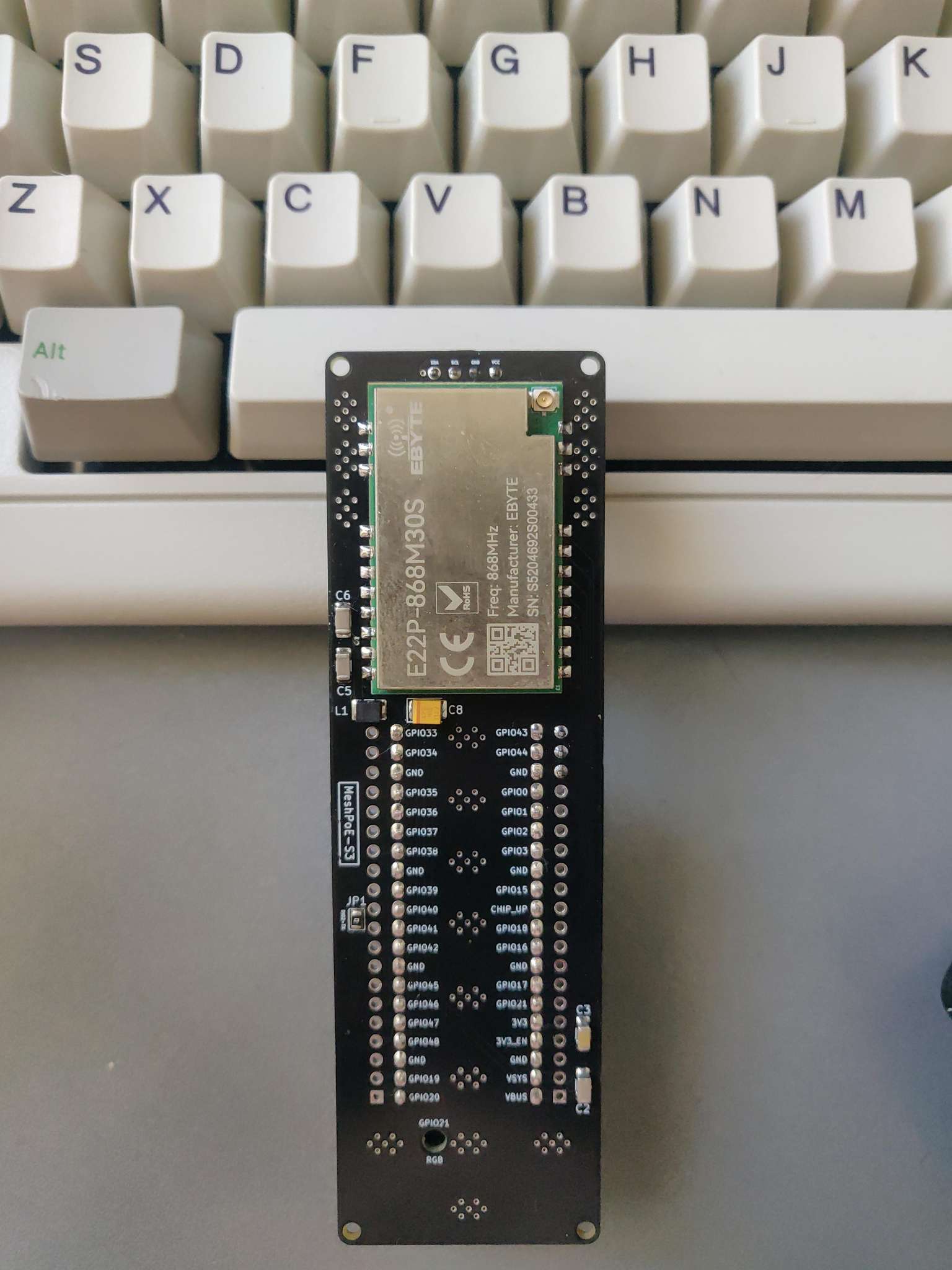

But after more than 7 months of work, it's somewhat safe to say I have MeshPoE-S3 working and serving my local district/area. The MeshPoE-S3 is using an eByte E22P-868M30S 30dBm LoRa module (but still compatible with E22-family of modules for different radio bands) that provides excellent performance for RNS over LoRa and runs on an off-the-shelf WaveShare ESP32-S3-POE-ETH devboard, which has 8Mb of PSRAM and can happily run a microReticulum Transport as well. It also has an optional RTC.

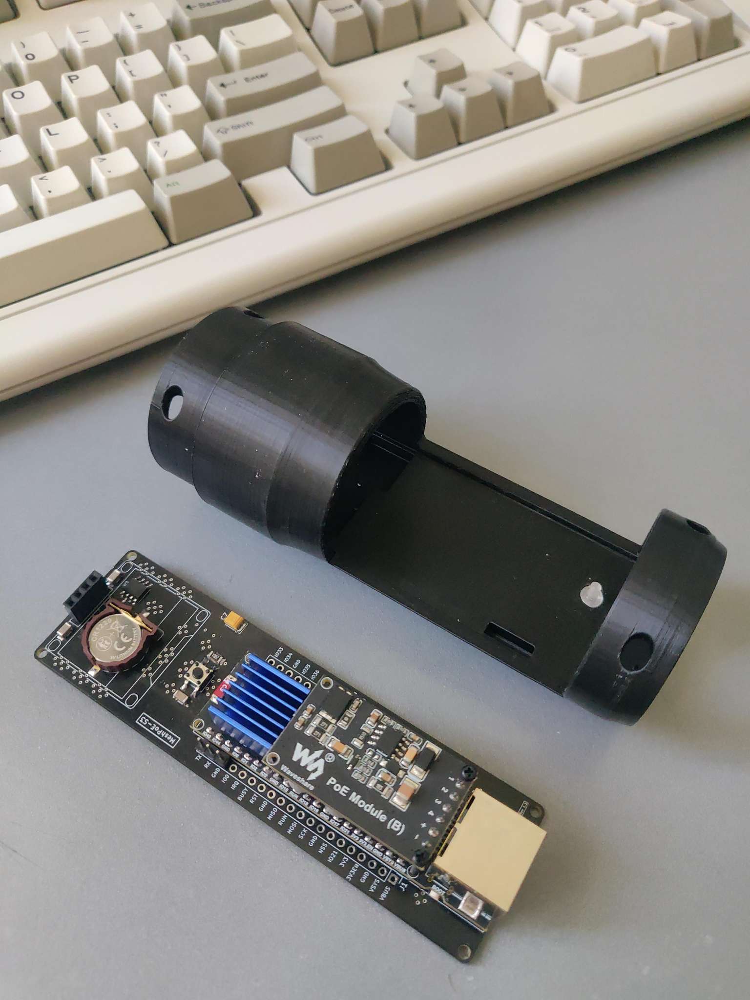

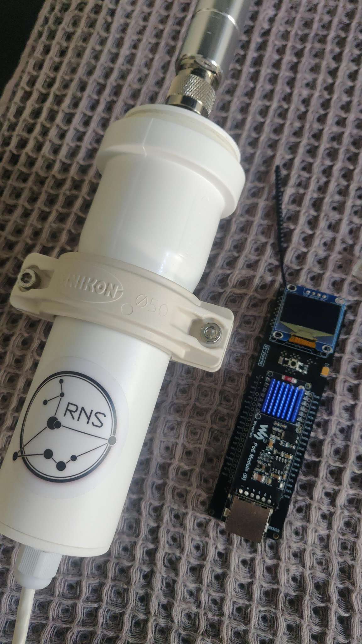

For casing and environment protection it uses a standard 50mm PVC pipe with a 3D-printed inlay that the board inserts into and the inlay snugly plugs into the pipe. The inlay is optional but nice to have. It has a standard 4-pin 2.54mm header to connect either an I2C OLED display for initial setup, or an optional environment sensor.

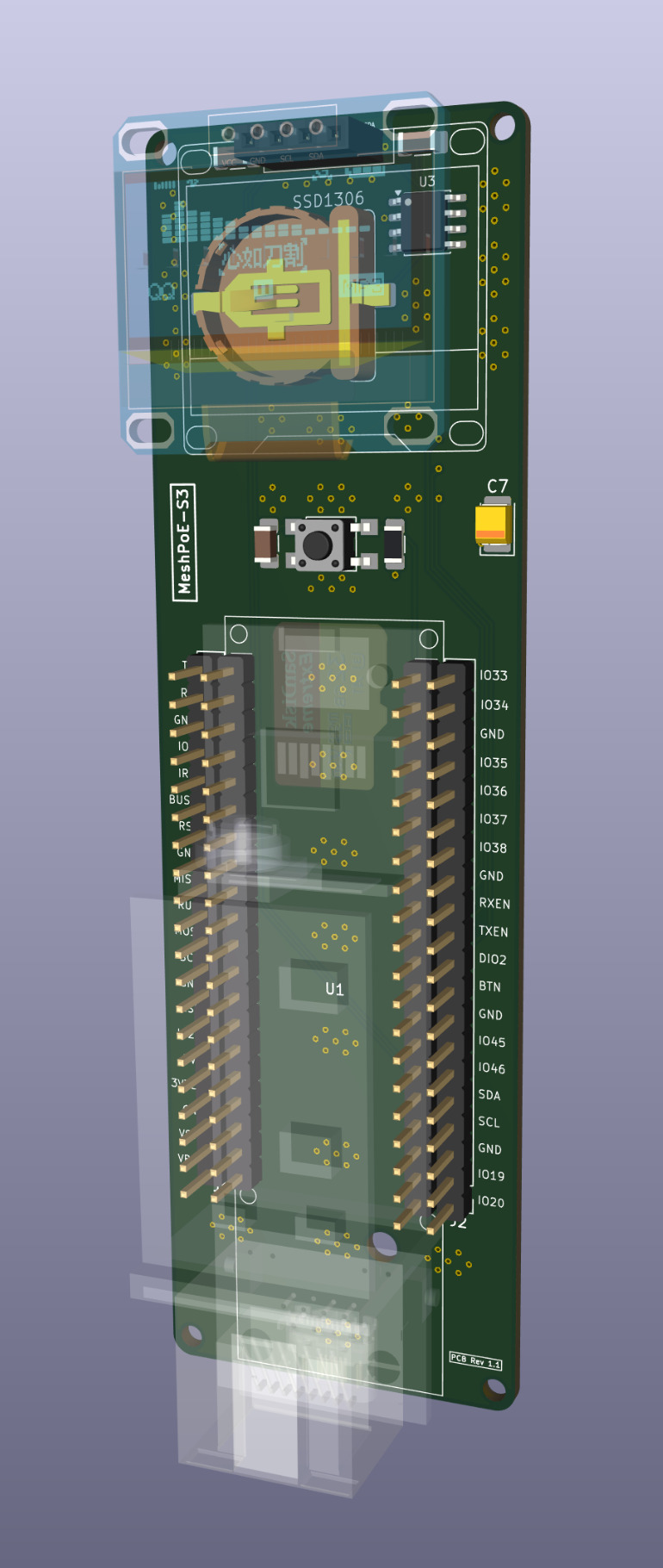

It has all the schematics, Gerber files for fabrication and a KiCad project if you're interested in adapting it for your needs.
https://git.rns.moscow/deuxyeux/MeshPoE-S3
