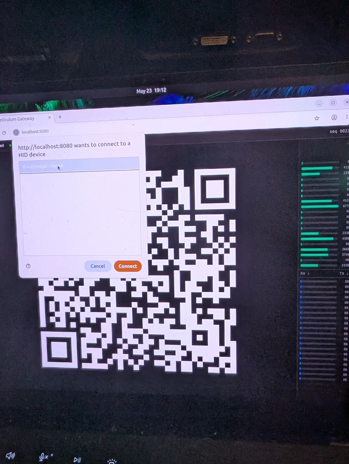

oh man I got COMPLETELY nerdsniped by this and went down a few paths haha, let me share:

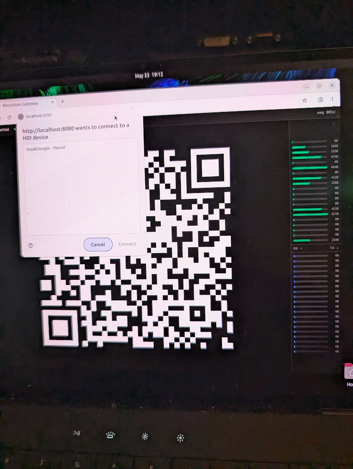

Core idea: There's a WebHID API in browsers. If you look at caniuse (https://caniuse.com/?search=webhid) it looks a little grim, but I thought, "Most Kiosks in the wild are probably running Windows, and therefore very likely to be running either Chrome or Edge, both of which are where support is quite good!". I figured if you can get through via USB with the HID trick in the first place, then the same kiosk is likely to allow the browser API too.
Three benefits: much higher bandwidth becomes possible, it's a bit more discrete (someone looking over your shoulder wouldn't see a bunch of QR codes. Not a huge deal but just something to note), and the consuming device doens't need a camera anymore either.
Now, because of conditional WebHID support, and quite frankly because the standard QR mode is WAY cooler, the thought was just to provide this as an optional mode to activate via the web page, especially since you need to approve the web page permission dialog for the WebHID anyway.
Got that working on Chrome for my Linux laptop (Chromium from snap didn't play well, but that's not really the target here). Couldn't help myself as I got into the optimziation flow, and got to a point where it was delivering ~300 Kbps goodput, basically bottlenecked by BLE instead.

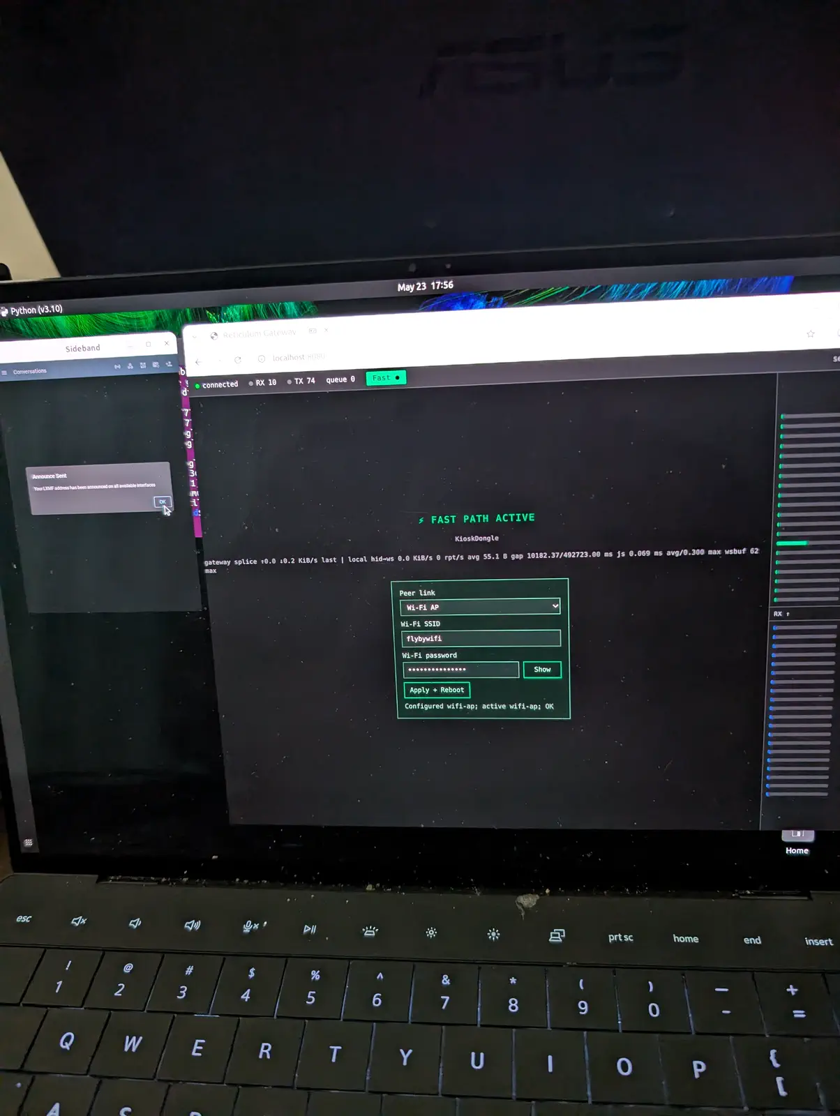

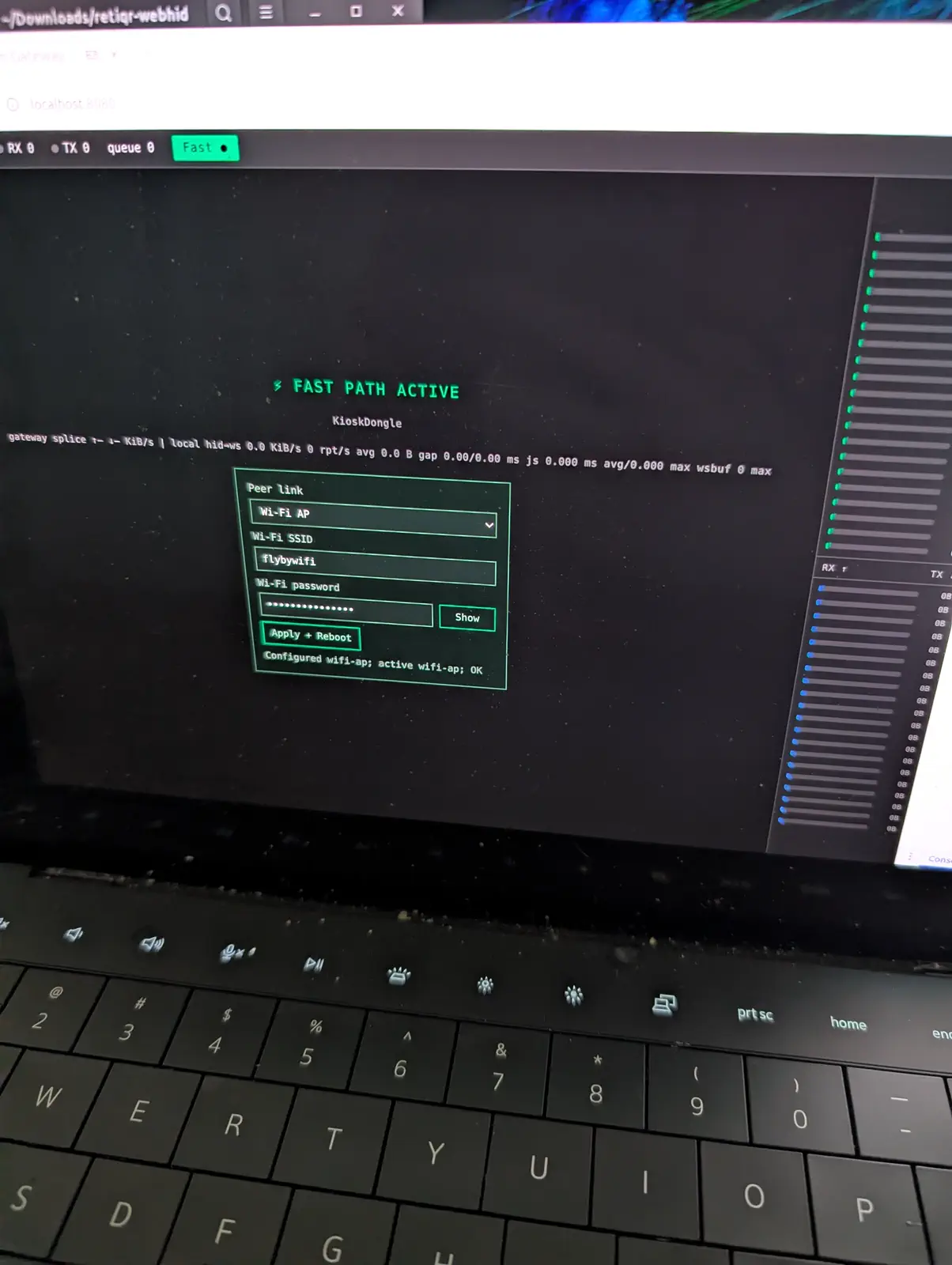

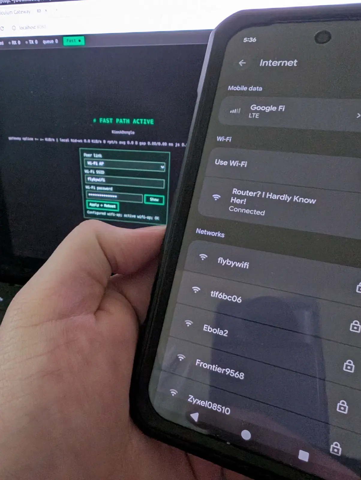

Alright! so as you can see, the web page allows you to configure the dongle as well. You can flip between bluetooth and wifi, and on wifi set the ssid and password to your choosing. (Note right now this is still designed for single-session links; I'm noting that in the PR for high value future work to make it multi-client, so everyone in the area can benefit if they know the creds!).

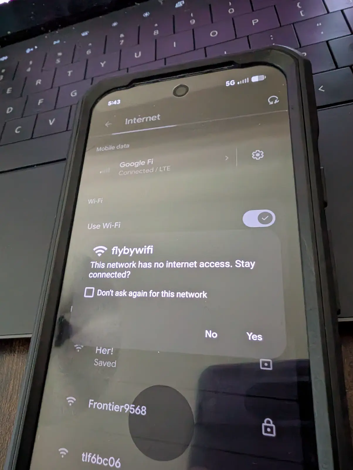

First up, showing that I see that valid hotspot on my phone, there it is! 'flybywifi' according to my settings on the web page.
And showing/proving it's not a real wifi connection, no internet. (Also note if any of you do this, make sure to check the box and say yes; won't work until you do).

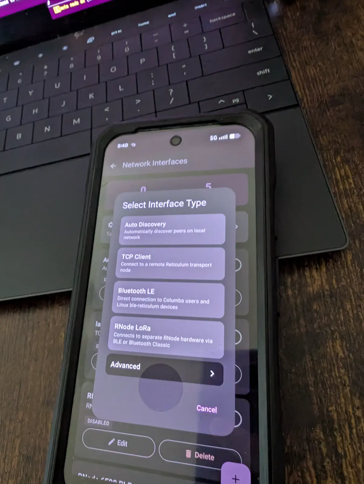

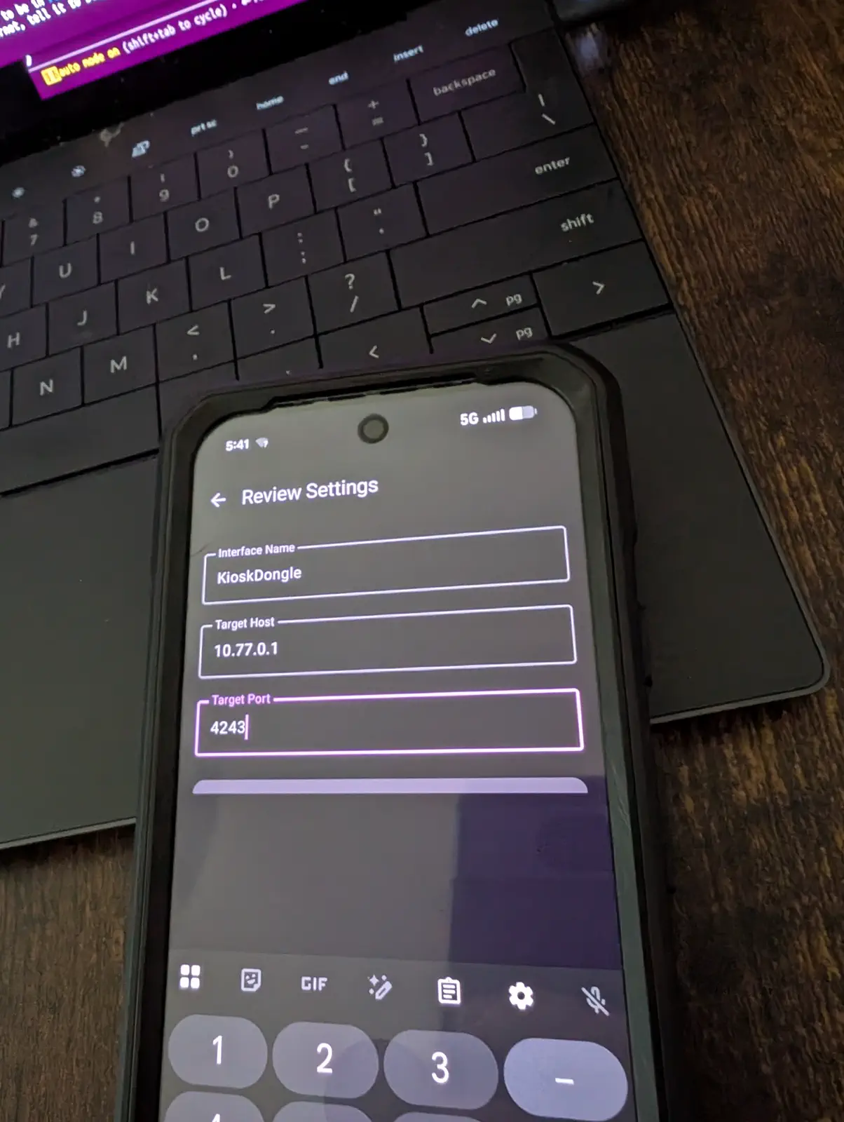

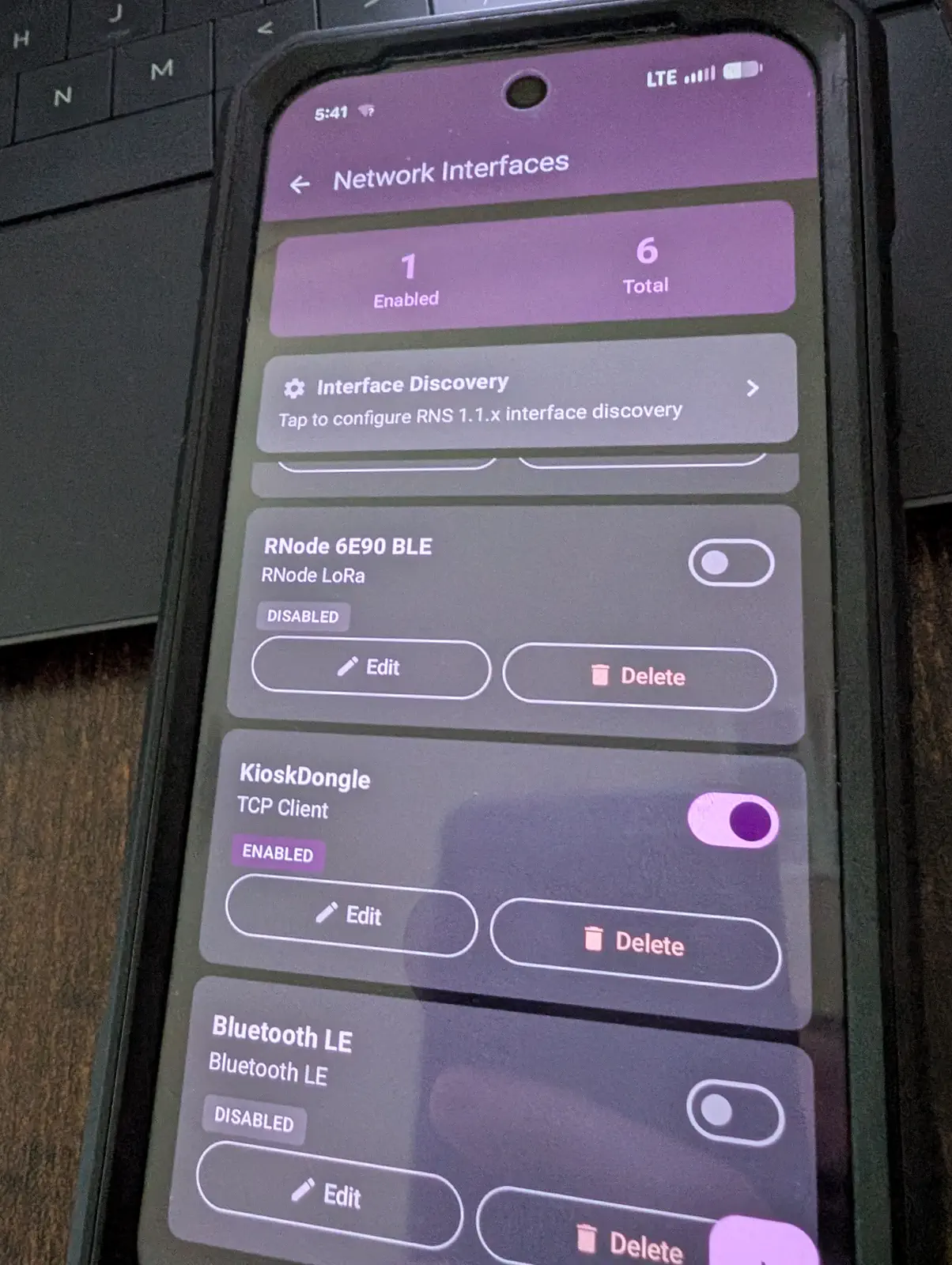

With that all set up, I opened up the fantastic Columba app and added a TCP client as normal
The host and port are still hard-set for now, to these values
Here you can see it's active, and it's the only interface active

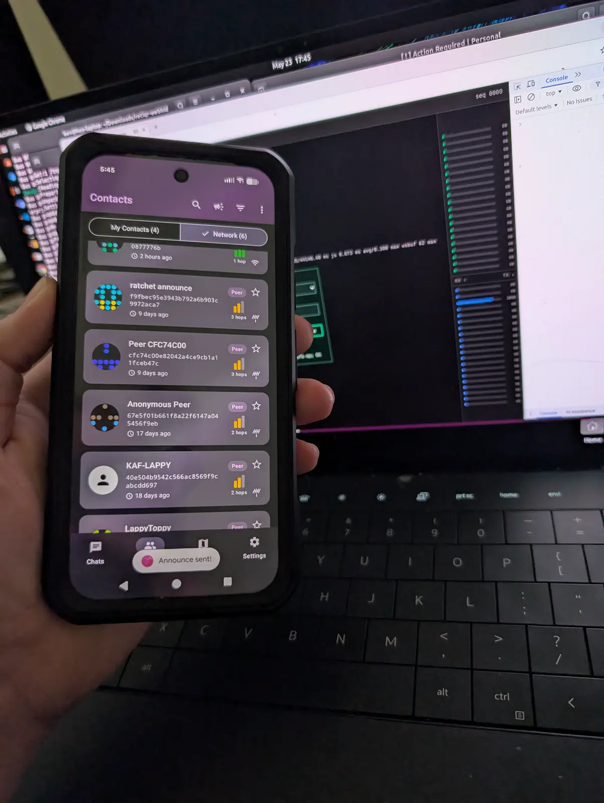

First moment of truth... before /after hitting announce:
There it is! Data's flowing from my phone!

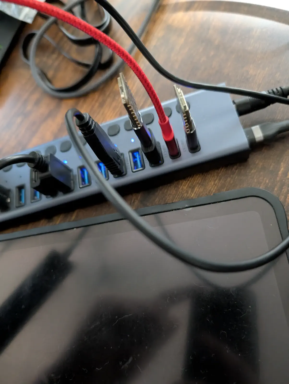

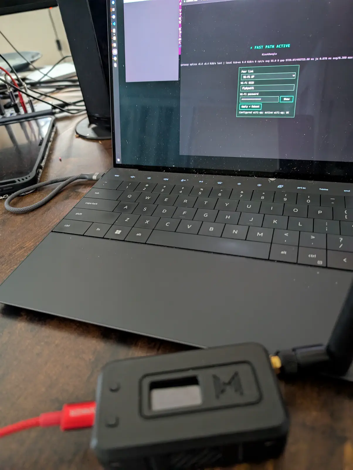

Oh sorry short sidebar to clarify my setup: I have a powered USB hub, the red cable is the one connected to my Heltec V4, which is my would-otherwise-be-RNode-but-is-flashed-for-this. so that USB link is what's talking to the WebHID interface and the onboard S3 is running the AP (sorry sx1262, you get to rest for now).
edited #12

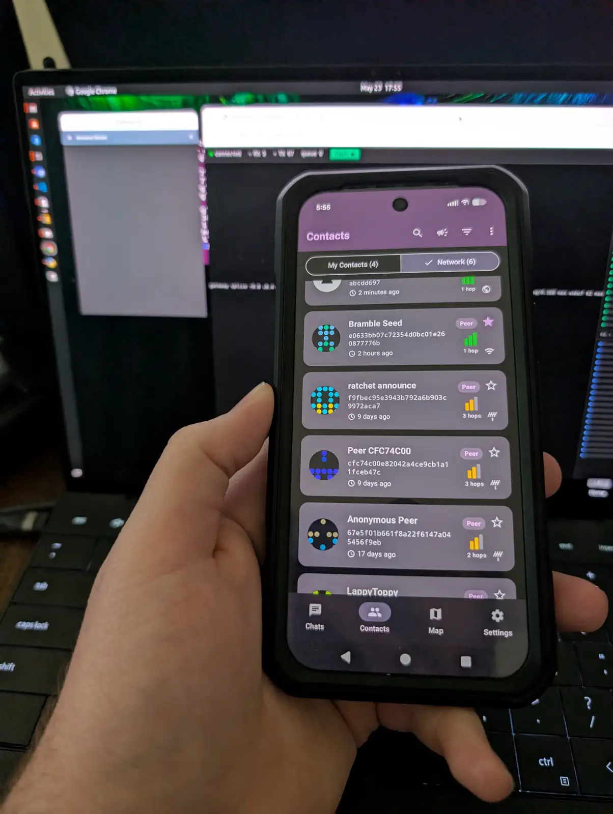

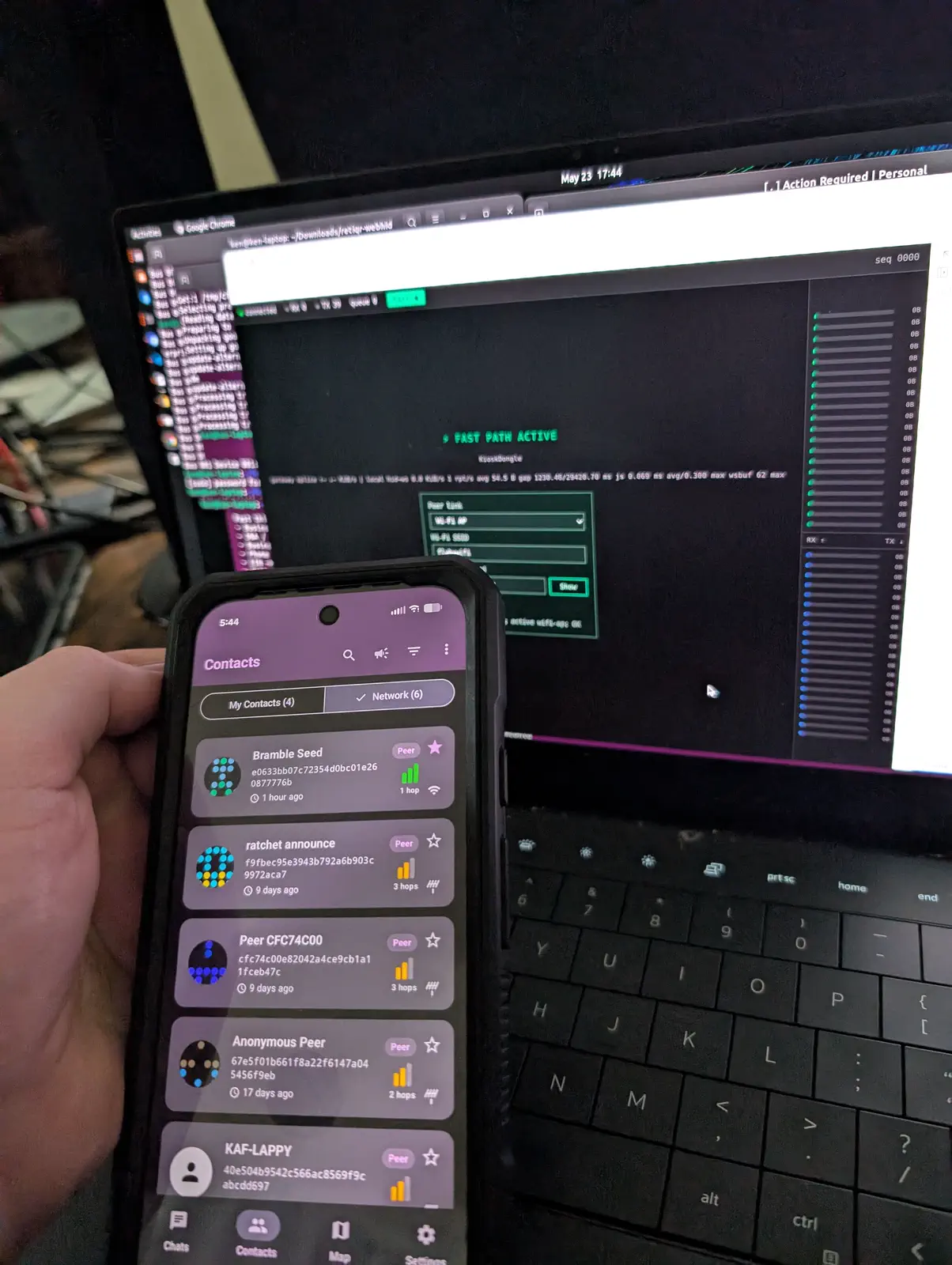

Ok back to the fun stuff. With Reticulum now running on my laptop, with only the local socket listening to the web server from retiQR, the two should be able to talk. And sure enogh, there's two announces flowing in the data, and you can see the Sideband app on my Laptop sees the announce (another before/after):

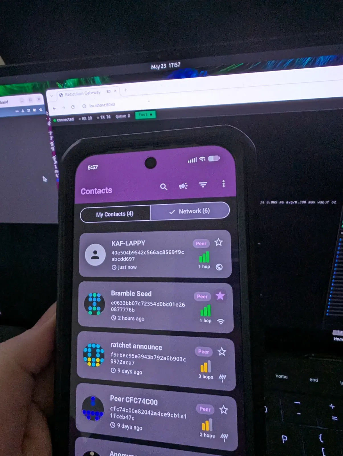

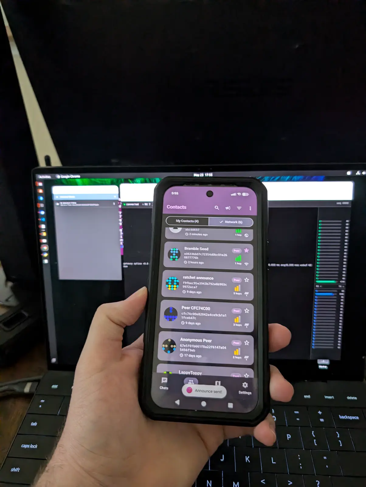

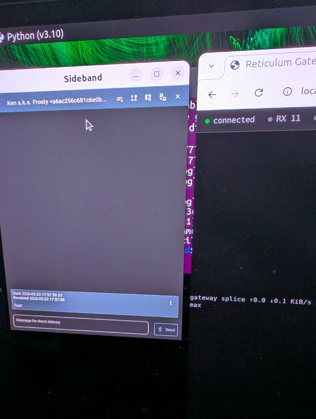

To isolate the other side real quick, here's sideband firing an announce and the green rx side showing hte data hit.
And here's Columba showing the announce!

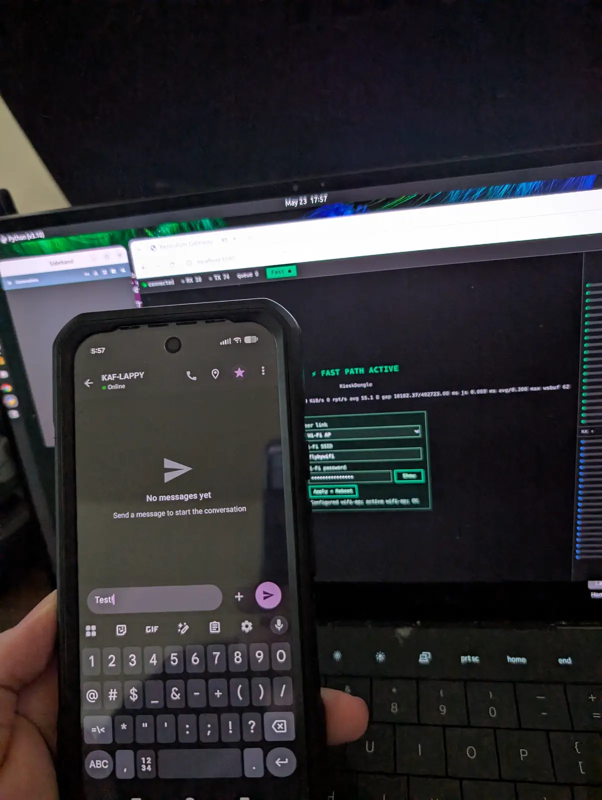

Alright, smoke test is good, concept proven. Now the fun part: moving some real data over this thing (coming in next post)
edited #13

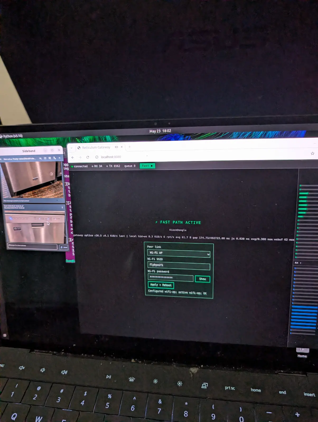

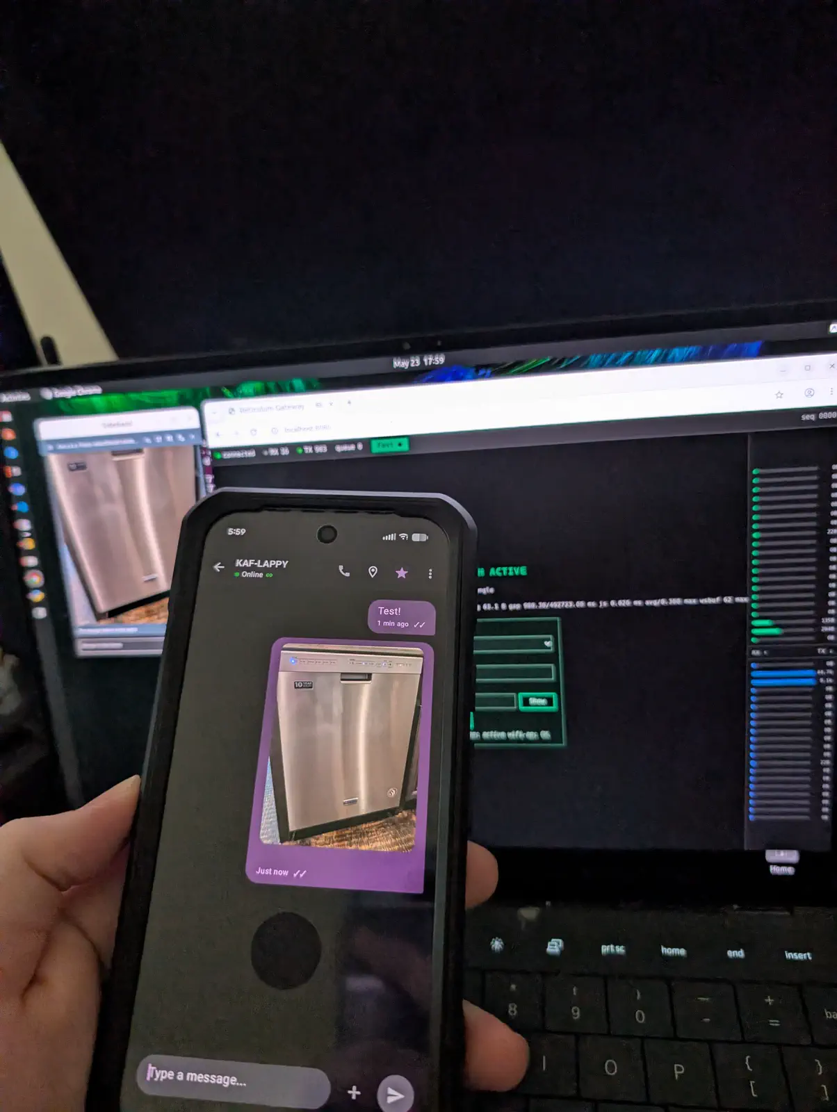

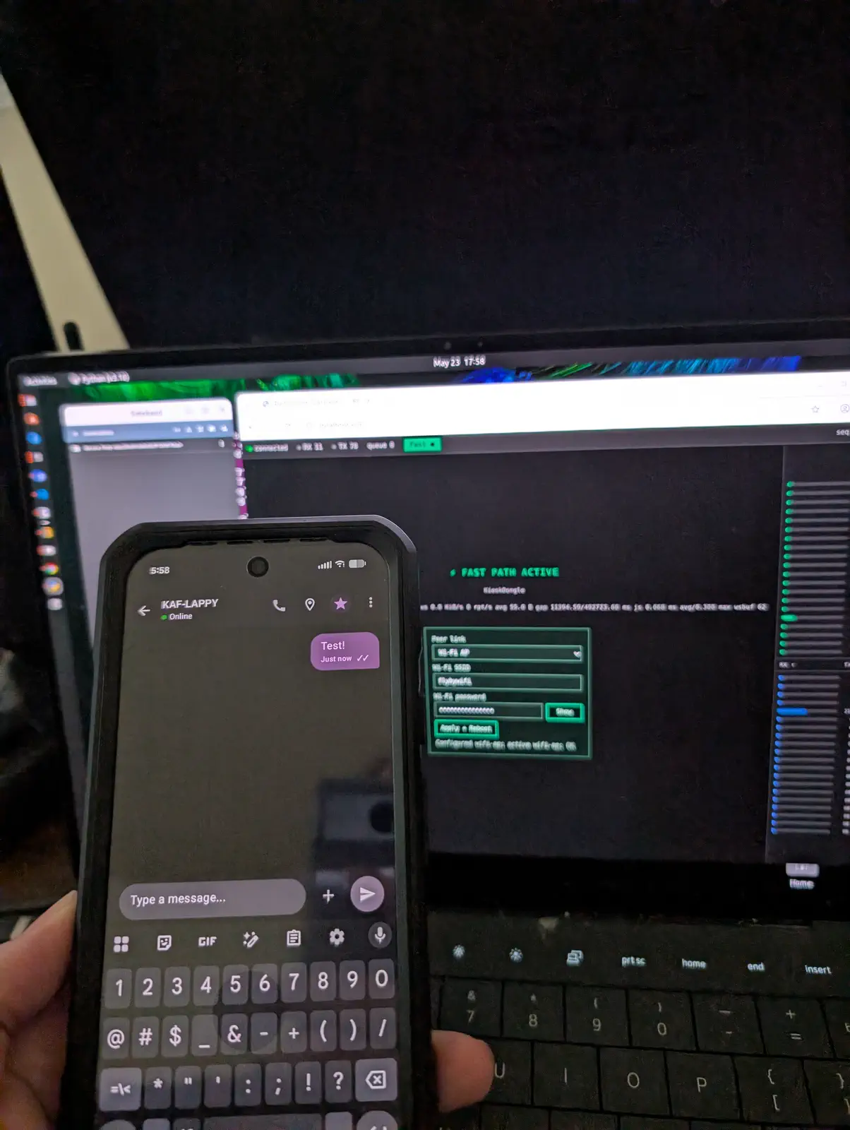

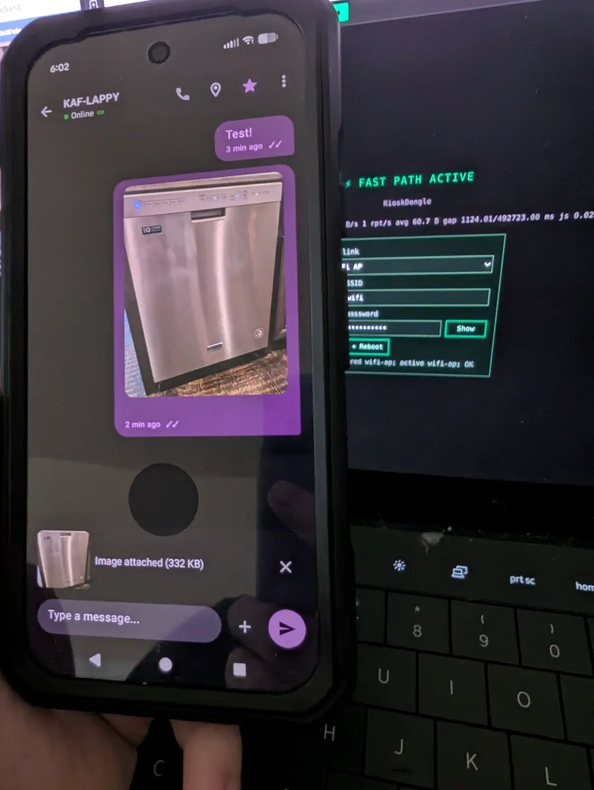

Messages sending! I figure we ought to see some larger data move though, to help show the bandwidth we're working with here:
(note the displayed bitrate above wasn't really the complete picture yet because we only sent a short text. Remember that, I'll come back to that in a sec). Anyhoo, latest picture was of my washer, so I figured it's as good as any to fire over

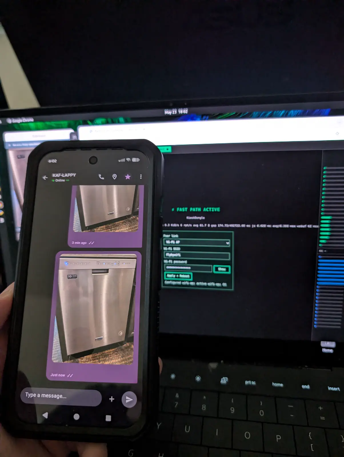

Success!!!! A nice medium quality image firing over what felt like effectively immediately, from when I hit send to when it showed on the laptop's Sideband.

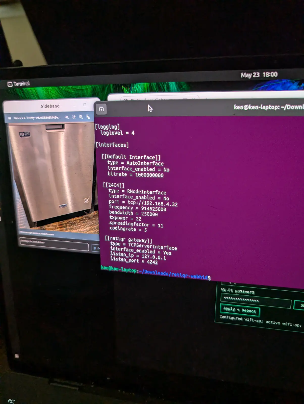

Also here was a cat of my reticulum config, showing the settings and also showign/proving it was the only live interface PXL_20260523_230023075.webp

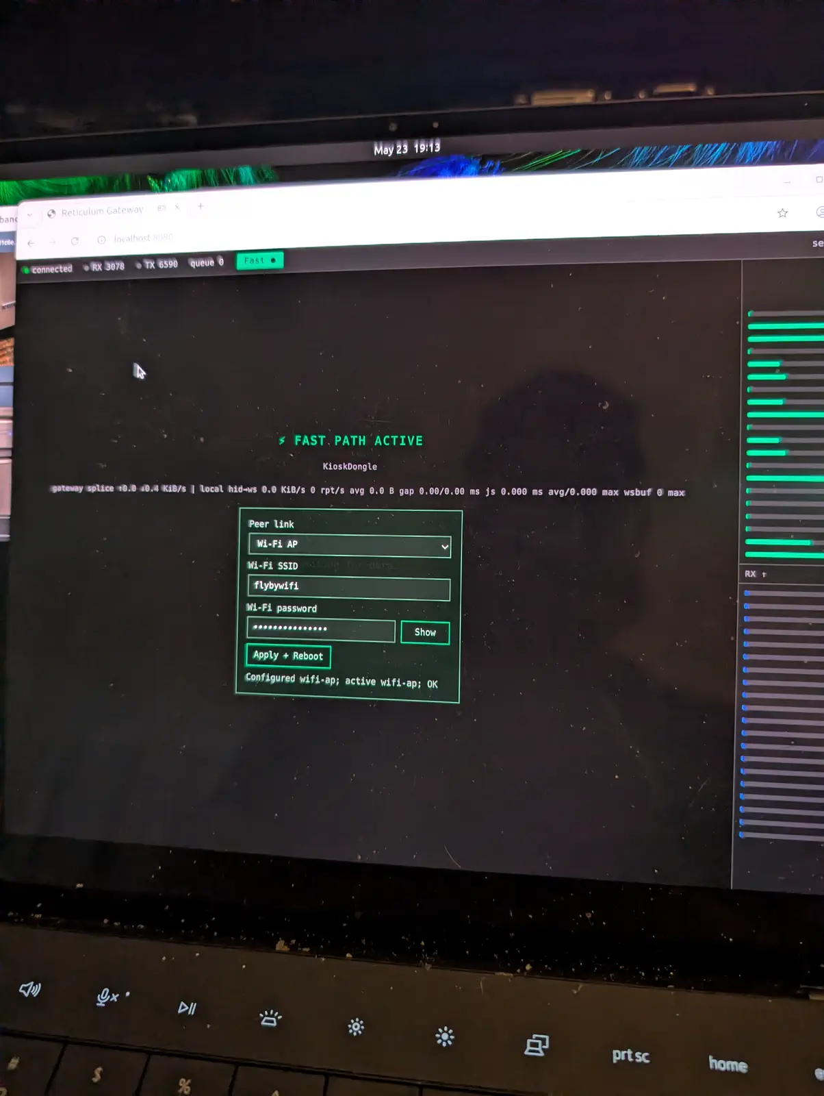

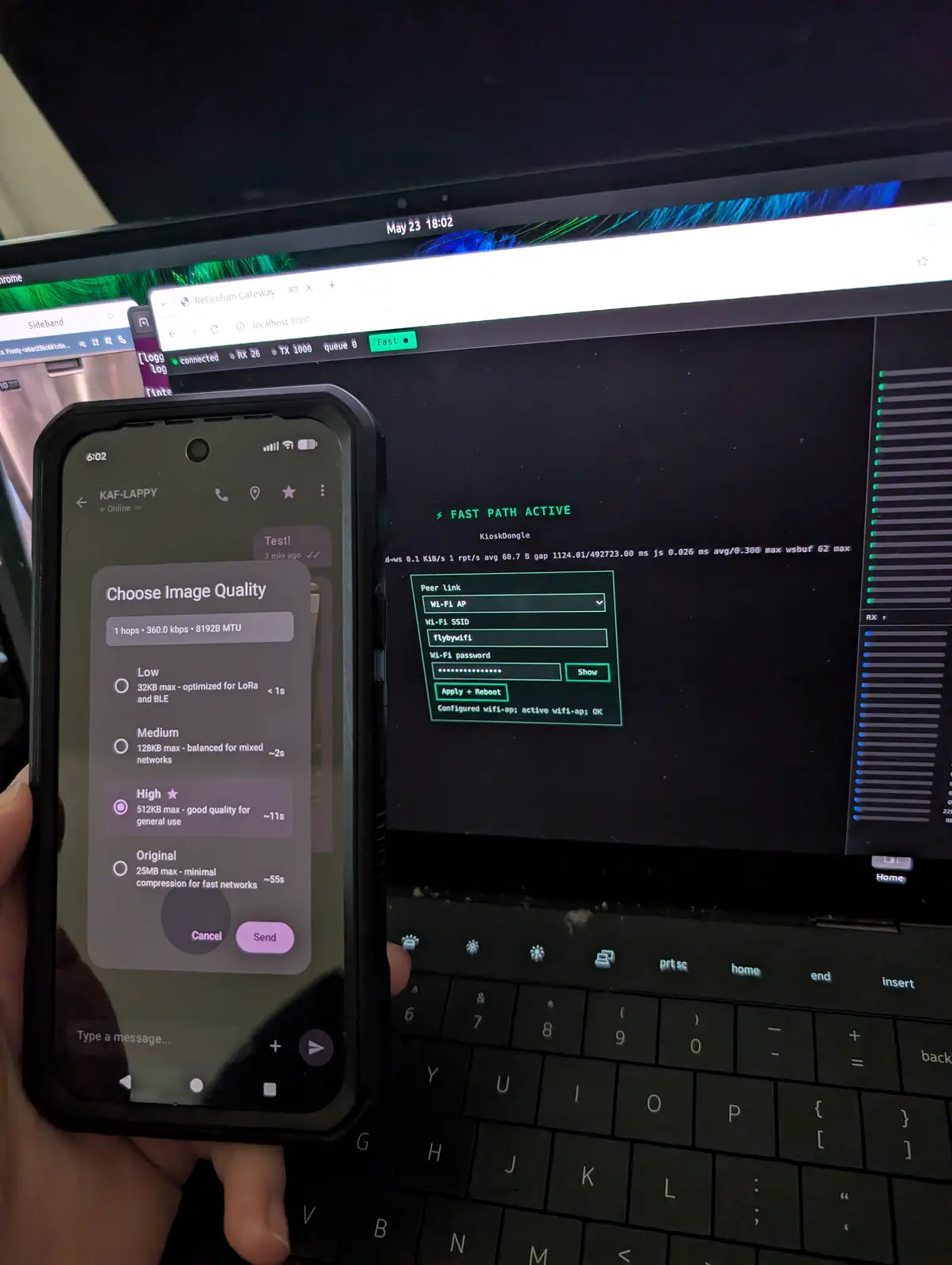

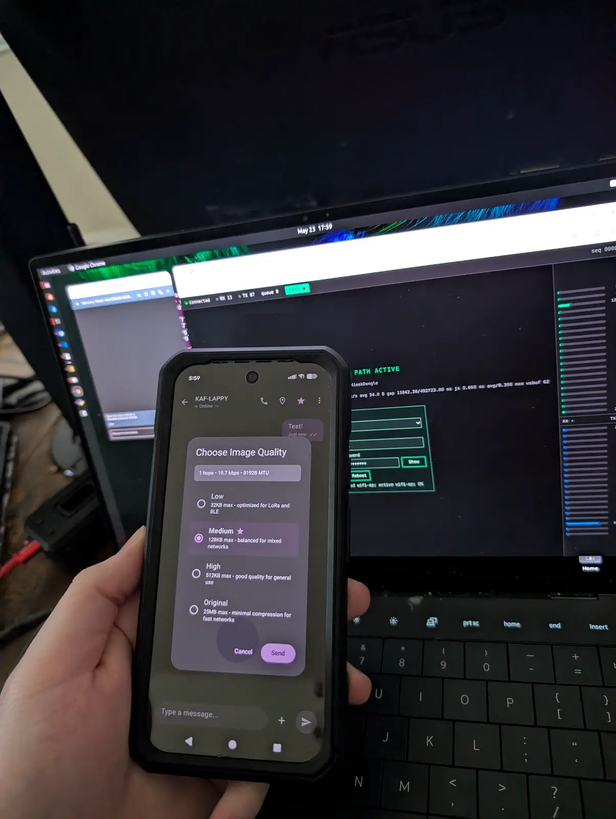

I figured let's push it a bit, so I bumped the quality up to send it again. PLUS, note here how now the bitrate shows our real effective limit after that first image sent PXL_20260523_230208270.webp
Just showing the size before send, ~330KB.
So this one took the ~10 seconds it estimated.
Then, after compltion, the confirmation it all sent, plus the data bars in the background showing all that time it occupied (and the asymmetry where one side is sending a large file and one isn't)
Including this one as well just to clearly see some of metrics showing on the page

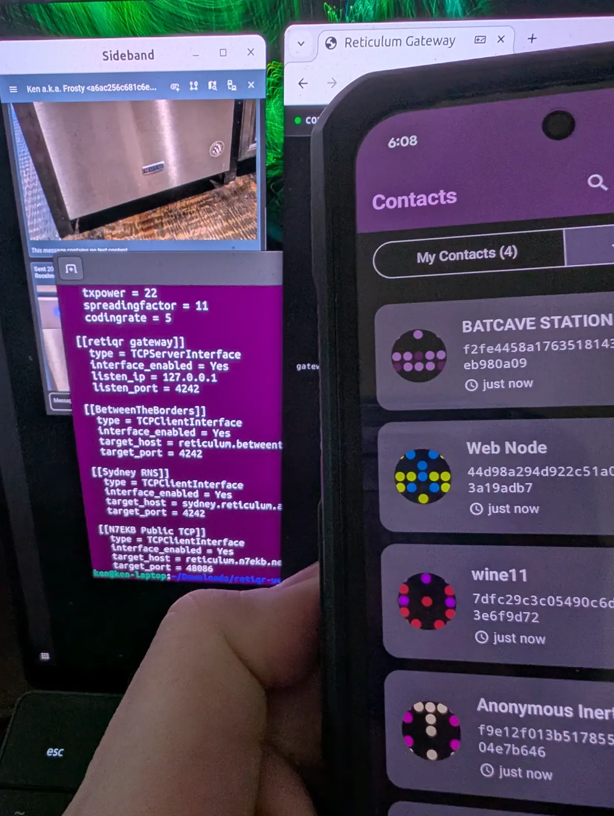

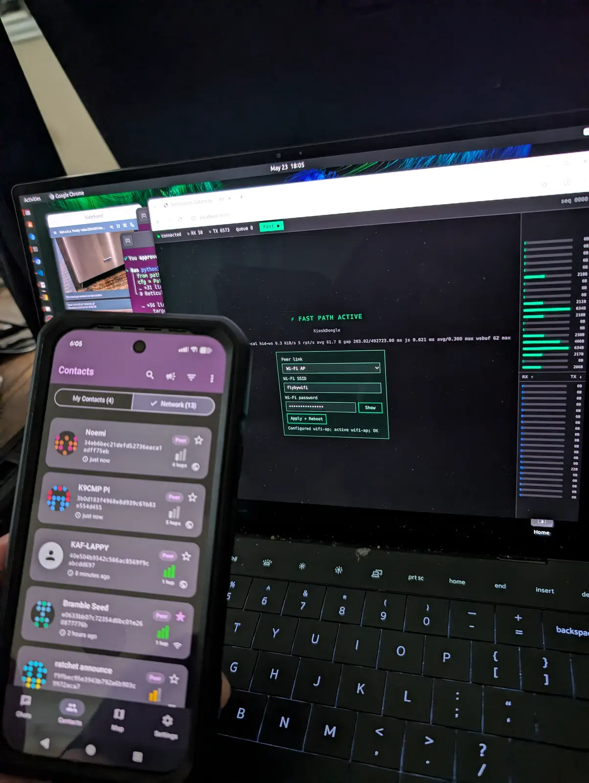

Then with my laptop as a transport node, I connected to a few community gateways, and now you can see Columba on my phone showing those distant announces now
Here's the interfaces again and some more announces:

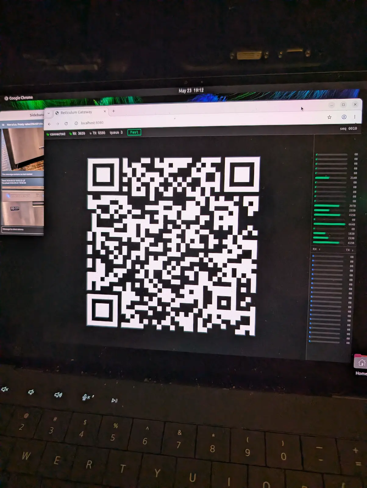

OH, quick followup! The fast mode can be toggled on/off and even in realtime. You can see here where I turn it off, then the general flow (with the cool as hell QR code system flowing behind it as everything stays connected)
Then finally just showing now I've approved the dialog and switched back to fast mode, it keeps goin.
