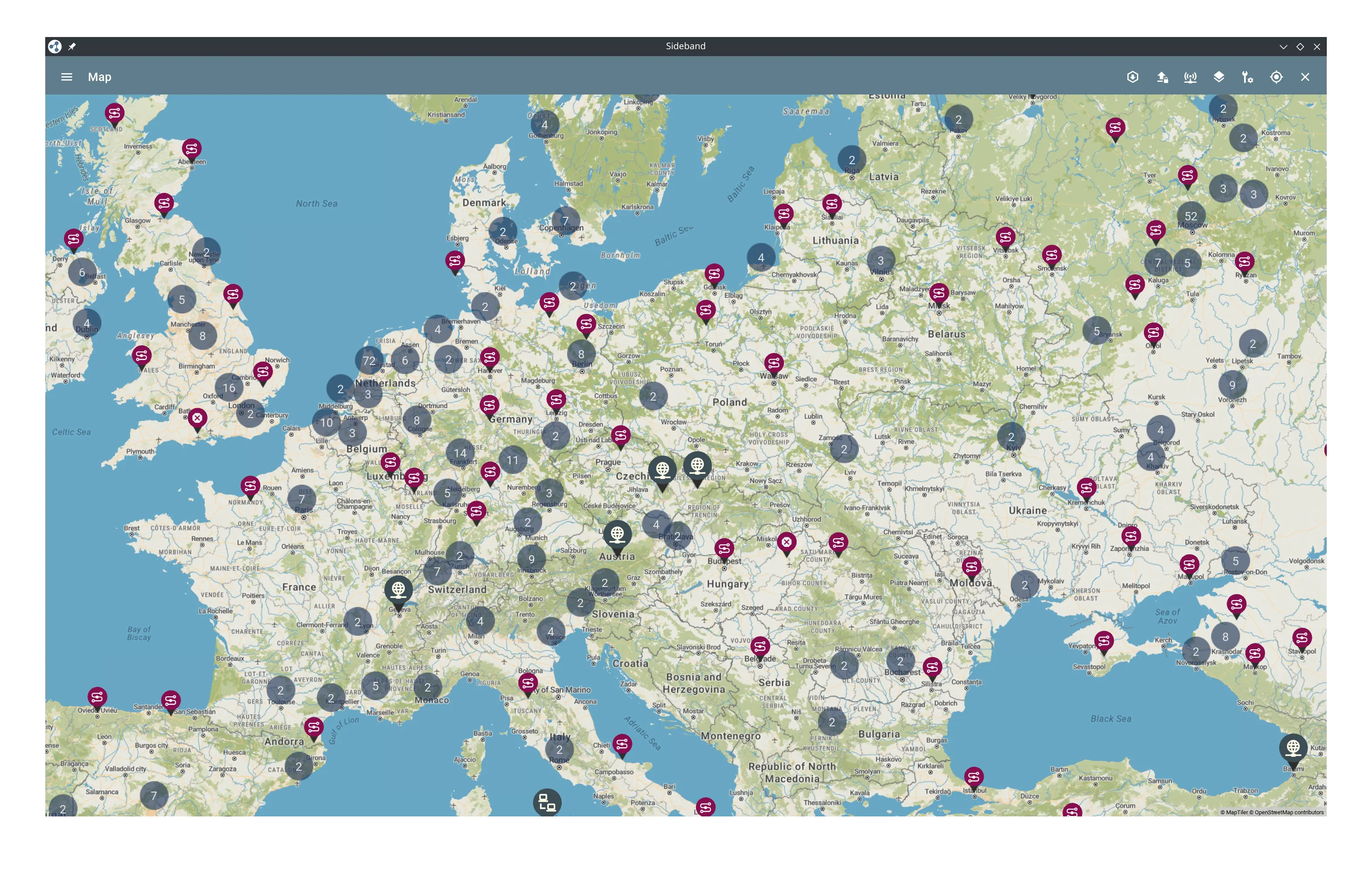

Here's a screenshot of a section of the map with around 1100 points loaded in total. Before the refactor, this would have been impossible, and completely dropped the framerate. Now it works, and with proper dynamic clustering/grouping :) Clicking/tapping on a cluster will zoom the map to the cluster's extents.
There's also scattering of close and directly overlapping points: If two points are very close to each other, they will get pushed slightly apart at the highest zoom levels. If a number of points share the exact same coordinates, they will get distributed in an expanding concentric ring pattern.
The map is now actually useful for showing many different points of interest, discovered interfaces, peers and telemetry entries :)

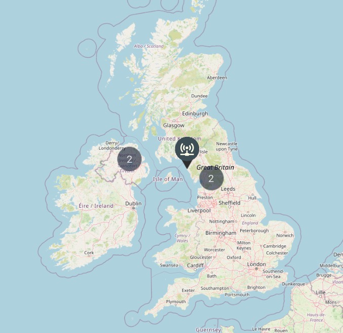

One thing I noticed is that I am not seeing hardly any nodes or interfaces on my map as you are?
I assume I am missing a setting to display some of these?
Mark Moderator 8dd57a7382268096...
#14
It may just be because your instance hasn't had time to discover enough interfaces yet. Generally, other nodes announce interfaces only one or two times every 24 hours, so if you leave the program running overnight (or at least just rnsd running), you should see the map populate.
This of course requires that you have discover_interfaces = yes in the config (in Sideband on Android this is turned on by default, though). You can also lower required_discovery_value, for the map above, I had it set pretty low, something like 10 or 12, I think, to just collect a lot of interfaces to test the map, and it was running on a system that had already collected a lot of interfaces.
