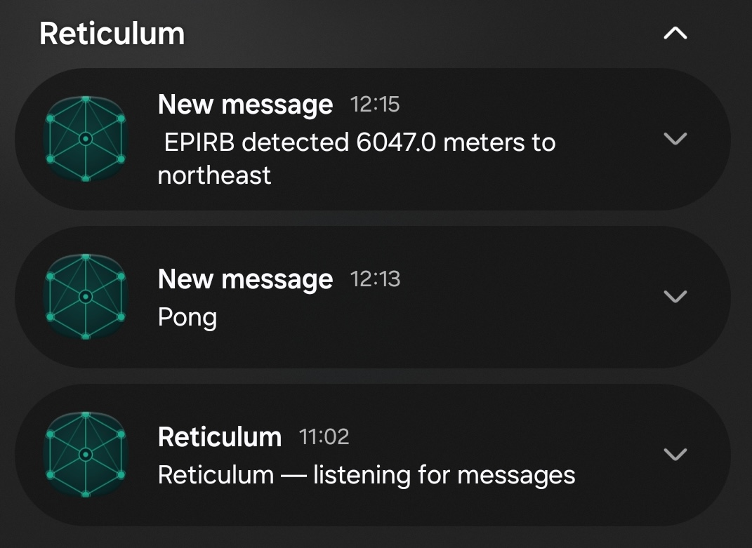

  • Alerts: Signal K alerts get sent to crew over LXMF

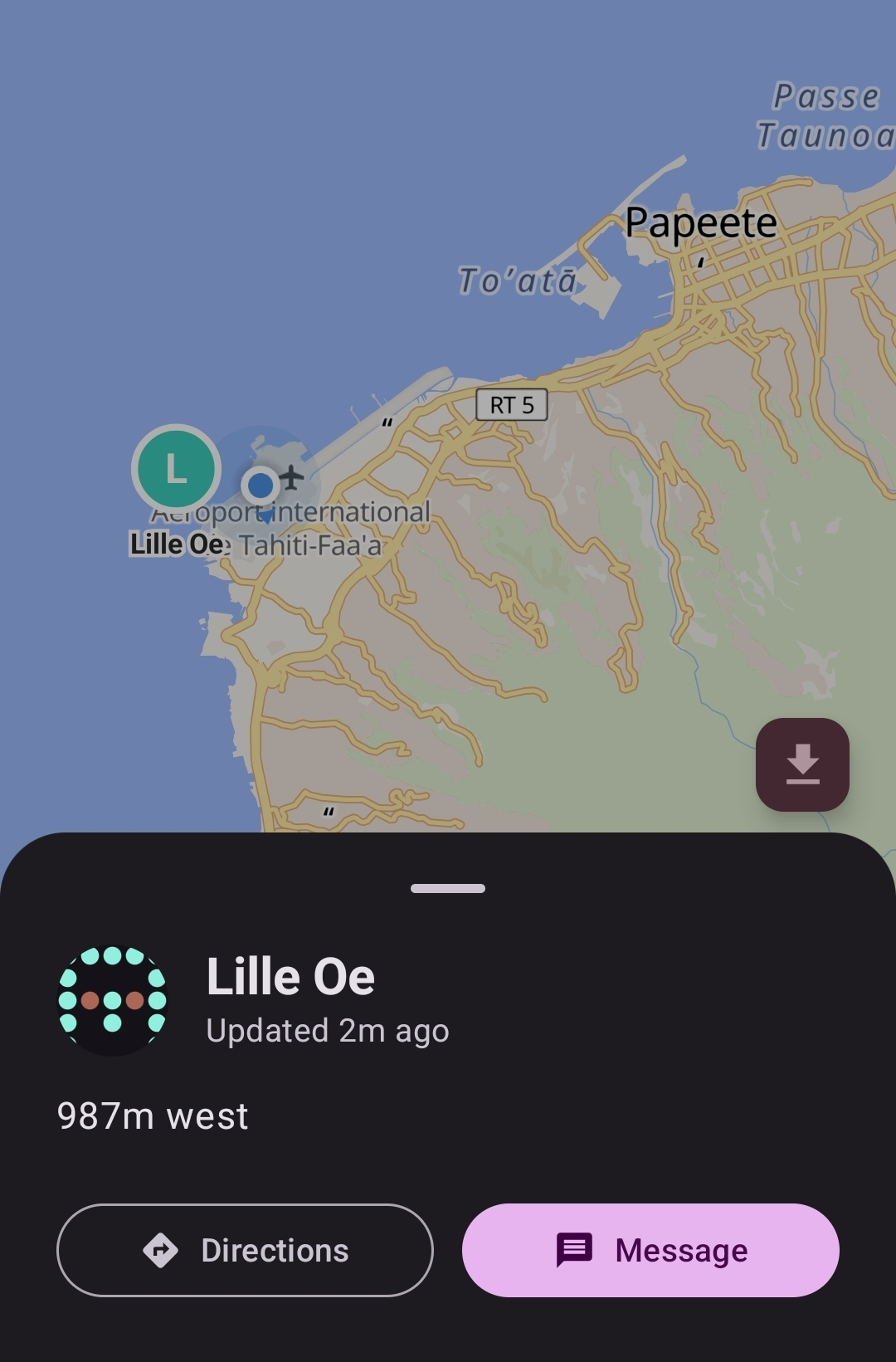

  • Telemetry: the plugin periodically sends telemetry (like position) to the crew

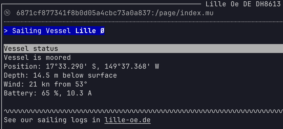

  • NomadNet: there is a basic NomadNet site for the vessel showing some status information
Down the line I'd like to expand the NomadNet implementation quite a bit -- it would be a nice interface for writing logbook entries, managing digital switching, etc.
