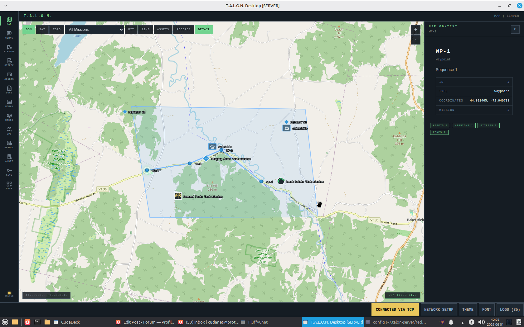

What it is - An application for group coordination. Use it for airsoft, or use it for mutual aid.

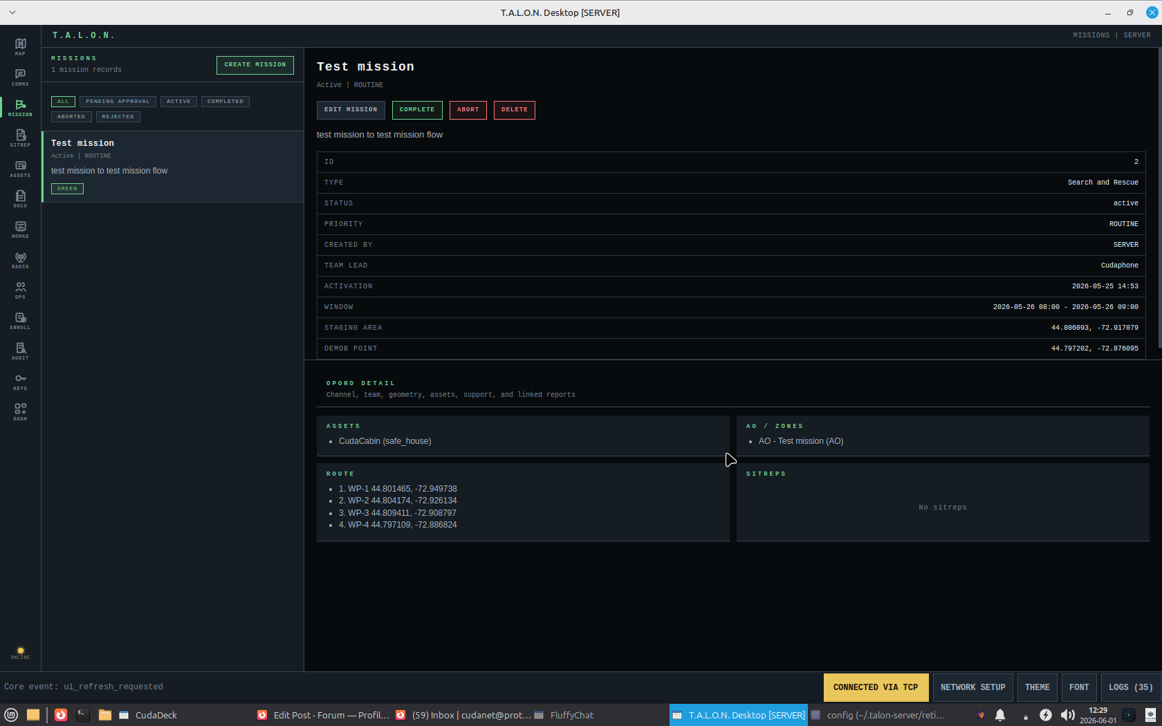

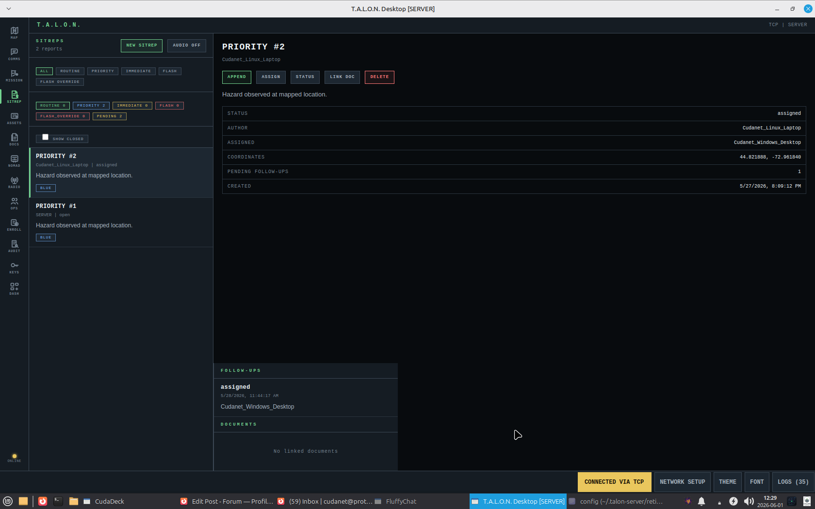

Maps- provide situational awareness. Operators can ping locations, create assets, sitreps or missions. Assets require 2 person verification. Missions require approval from server
Assets- People, caches, vehicles, safehouses, or build your own custom ones

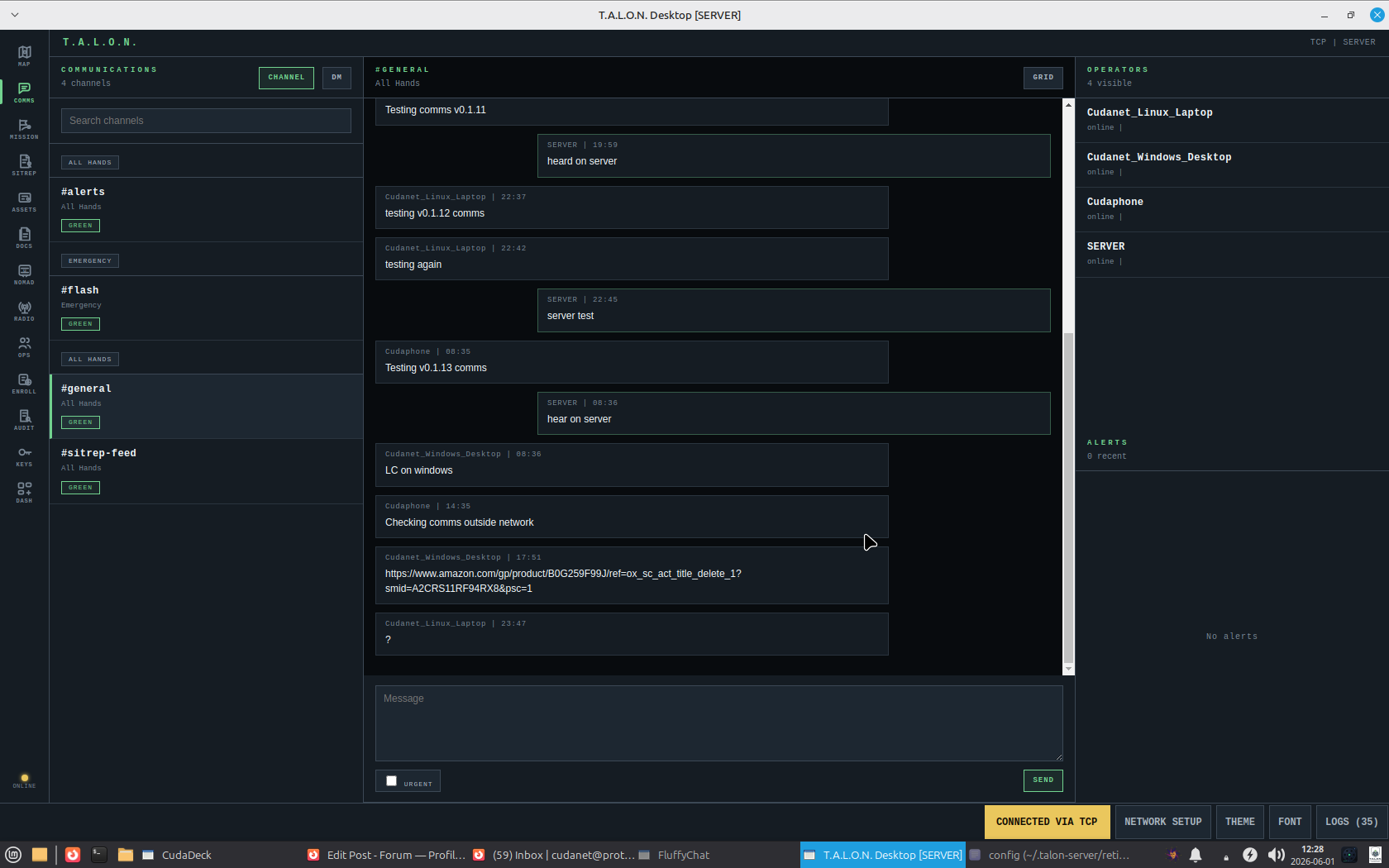

Comms- Missions automatically create specific channels, servers can create rooms.

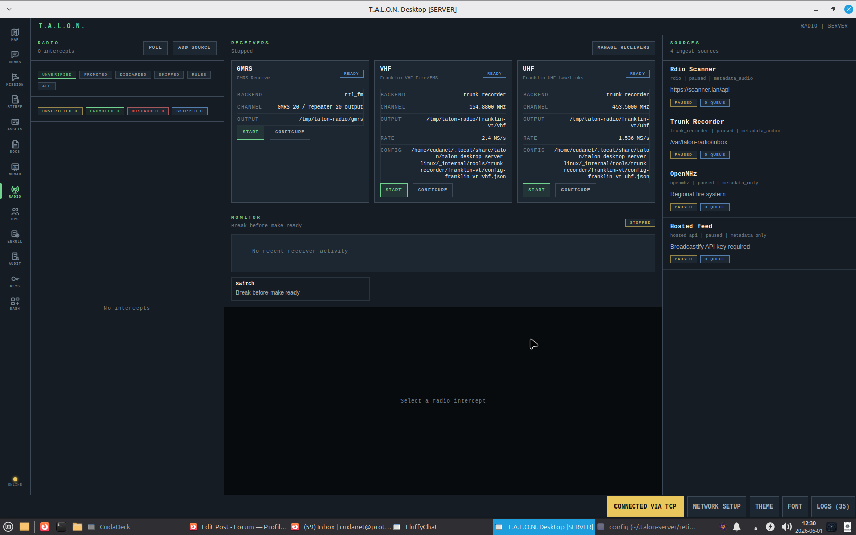

Radio - support for SDR radio ingest across a variety of profiles

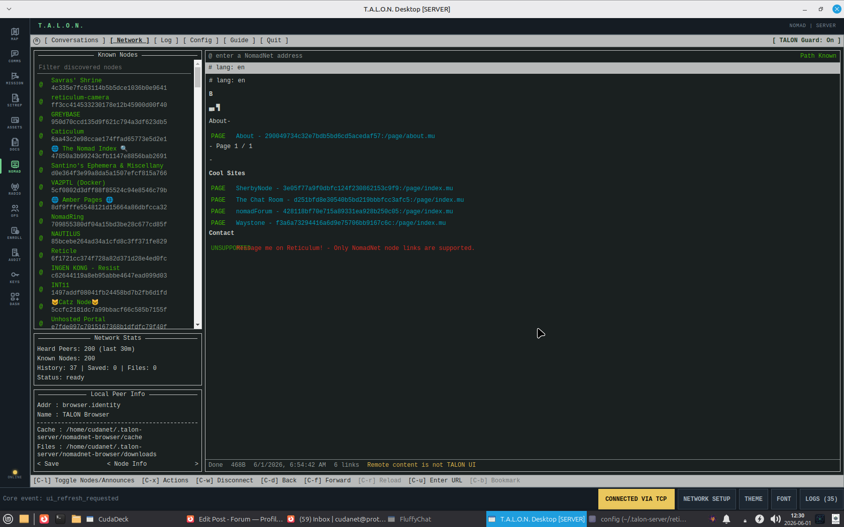

NomadNet - I had no justifiable reason for including this, and it does come with some security concerns but I like it. In the future I plan to build in a server proxy, so the server itself is the only thing touching NomadNet, and clients can browse pages via the server. The scaffolding for that is done.
