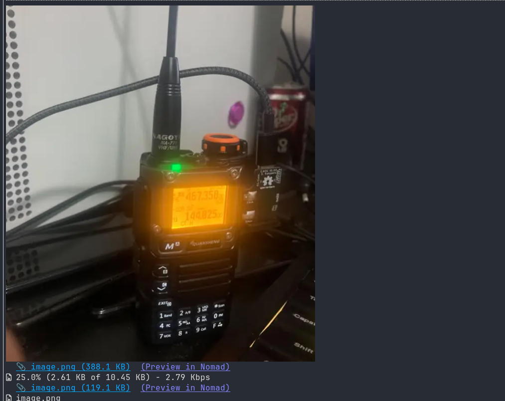

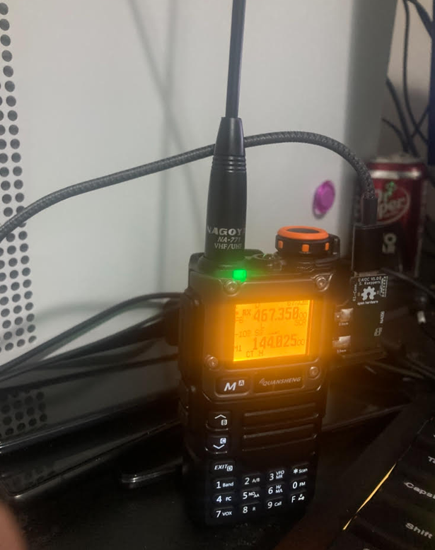

Yes, right now. Well, not technically 2 meters but 70cm, still the same deal.
My setup is a UV-K5 with an All-in-one audio cable running modem73 with the modem73interface. The UV-K5 is connected to my desktop via a USB-C cable.
In modem73, the configuration is using COM PTT, with mode QPSK code rate 3/4ths. There is a Raspberry Pi 4b and another UV-K5 out in my car connected to a power bank with a cigarrete plug battery eliminator and another AIOC.
The Pi4 is setup to run as a Transport node in boundary mode. It's a distance of only about 400 meters or so but I've tested modem73 out to 5+ km line of sight, and over thousands of km HF.

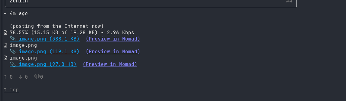

(posting from the Internet now)
You can even load images if you are patient enough and have a clear channel (took about 43 seconds per image @ 8PSK 3/4)

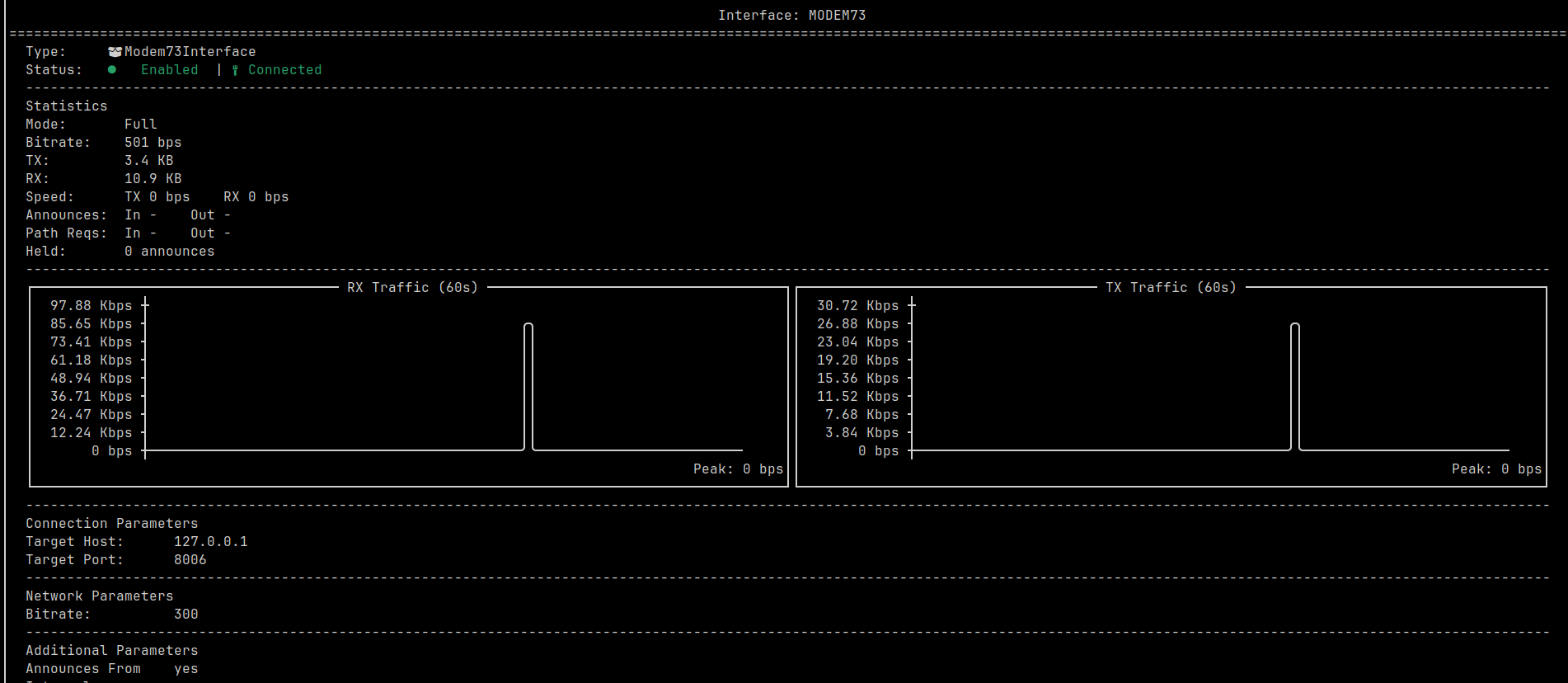

Thanks to everyone for all of the responses. I finally got to reading them all and have used your information to hook up my digirig with modem73 and was able to get reticulum transmitting over it.
