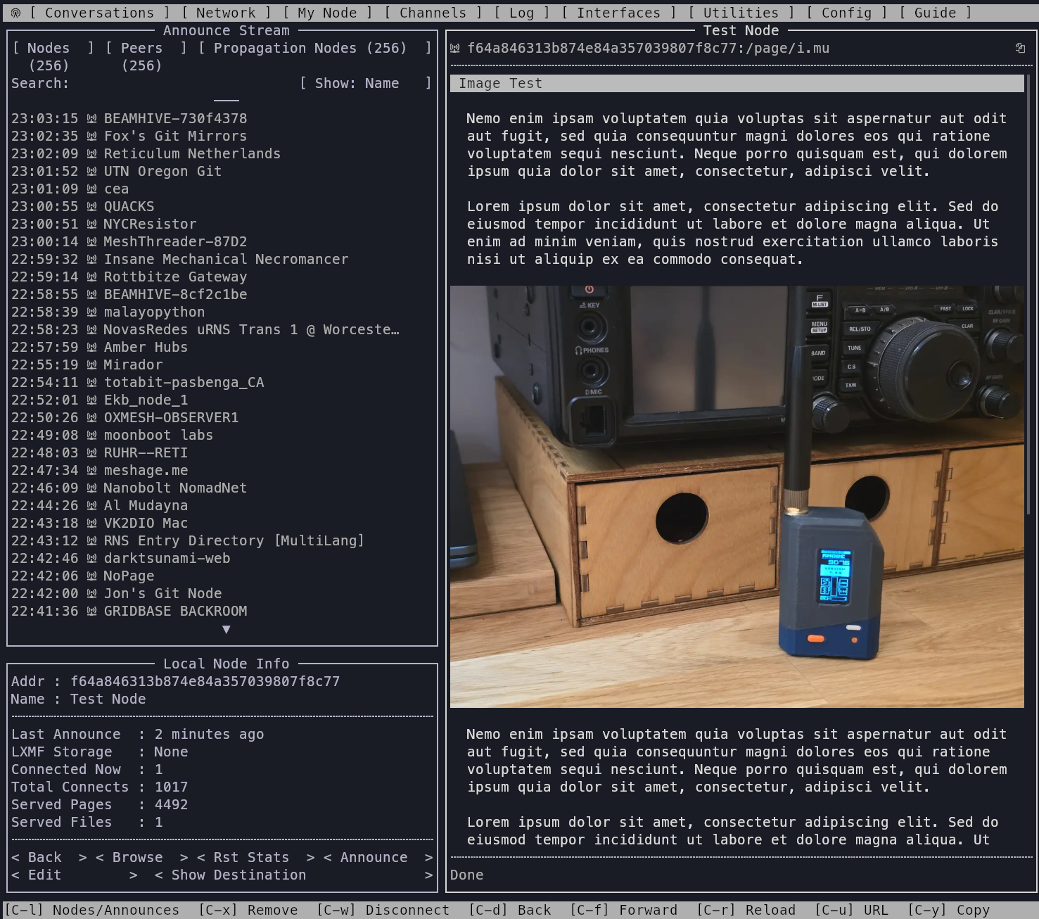

Is it something we want?
Mark Moderator 8dd57a7382268096...
The screenshot is not a mockup, it's running live in nomadnet, but it is just a prototype for testing out whether it was actually viable.
Currently, it's only the client-side parts that are implemented, which, while not the simplest thing to get working, is really only a pretty small part of it.
The more important part is getting the whole serving side right, so that low-bandwidth connections aren't choked. That means it needs automatic scaling and compression for low-bandwidth peers, selective image retrievals, and having everything configurable and user-selectable, so pages with images can still be fetched in light-weight text-only mode.
Forgot to say, currently, I've only tested it in Kitty and Konsole. It should work in any terminal that supports the Kitty Terminal Graphics Protocol. I'd be really hesitant to add other terminal graphics protocols to the rendering backend, since most of those would require really heavy dependencies to handle image slicing, scaling, et cetera, et cetera. As it's implemented now, there's zero new dependencies; everything is handled in pure Python, performs really well, and is light on resources and memory. The terminal itself does the heavy lifting.
It also supports image buffer re-use, so the raw image data is only written to the terminal once, and can be re-used for as many image instances as required in a very light-weight way.
It supports basic sizing and alignment, such as setting width/height in cols/rows or percentages, and setting left/right/center alignment.
I'd love to hear what people think about this.

Same oppinion here! Hey, you got an HF rig?!

Oh sorry, I meant Mark's picture in Nomad! 73 de LZ1SWE
