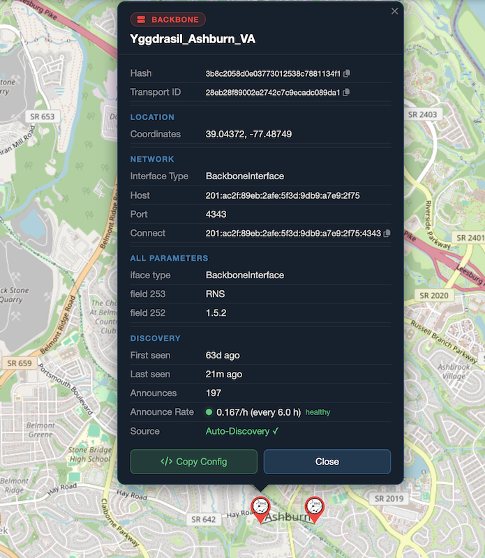

b1LL 92b5b2883c81d16c...
I believe rmap doesn't display discovered Yggdrasil interfaces given there are quite a few in the network and rmap doesn't have a category for them.
They should just fall under backbone, right? I was trying to copy this node on rmap
I was unable to successfully contact them unfortunately. Unsure if the lxmf address is still used.
